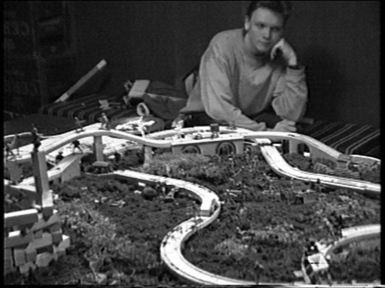

    Thanks for replying! Here is a screenshot: It's not the picture quality that's the problem only the missing colors. The colors disappear for a couple of frames and return, and it happens every 1-10 minutes (depending on the quality and age of the source, I suppose). By picture changing I mean when moving the camera around while recording(or when for some reason what's being filmed is moving fast) and not a change of scenes.

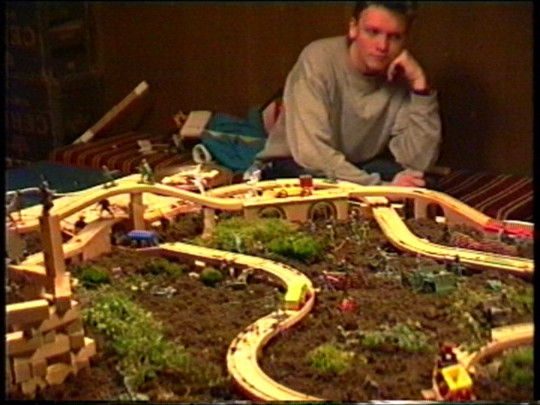

    This is what the frame just before looks like: - I couldn't figure out how to put two pictures in the same post.

    To answer the video problem, I really don't know. Now that you have some images up there it gives a better idea and possibly someone else will stumble across it. Have you tried different tapes? Do they all do it or just this particular one?

    What that sounds like to me is vaguely familiar to a false Macrovision signal, It may even be something similar such as the DV cam not getting a good enough signal. MV is for protecting copyrighted material. Sometimes with older analog tapes you errors or weak signals and these are interpreted by the capture device as MV giving you screwed up video.
    The reason I say vague is because usually the video is complete trash and unusable. You on the other hand have usable but B&W. The other thing to note is when your trying to capture a tape that is having these issues you get the same results you do where it's intermittent. Might get 5 minutes of great video maybe only 1 minute before it pops up and goes away.
