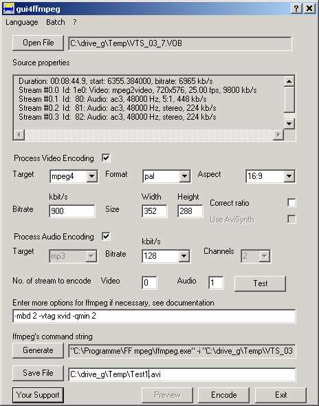

How to convert DVD to DIVX/XVID with gui4ffmpeg
Single VOB
1 Load the VOB file with Open file
2 Select mpeg4 in the Target list box.
3 Choose PAL or NTSC in the Format field.
4 Under Aspect you should use the aspect ratio of the source.
5 Change Bitrate and Width/Height optionally.
6 Change audio Bitrate optionally.
7 Enter correct Video and Audio stream.
In the Source property field is displayed:
Duration: 00:08:44.9, start: 6355.384000, bitrate: 6965 kb/s
Stream #0.0 Id: 1e0: Video: mpeg2video, 720x576, 25.00 fps, 9800 kb/s
Stream #0.1 Id: 80: Audio: ac3, 48000 Hz, 5:1, 448 kb/s
Stream #0.2 Id: 81: Audio: ac3, 48000 Hz, stereo, 224 kb/s
Stream #0.3 Id: 82: Audio: ac3, 48000 Hz, stereo, 224 kb/s
The video stream is #0.0 Id: 1e0: Video,
you have to enter 0 into the Video field. Three audio steams are available. If you don't know, which is
the right one, you can test them.
Enter the stream number of the first audio stream (#0.1 Id: 80:
Audio) into the Audio field.
Press the Test button. Ffmpeg's DOS box occurs and the audio will be encoded. Close the DOS box after a few seconds.
The standard media player will be opened. Listen to the audio. Is it the correct language, continue with step 8.
If you want to encode more then one VOB file from the same DVD,
remember the Id of the audio stream, in this example the Id of the first audio stream is 80.
If the language is not correct, test the next audio stream.
8 Select the output file with Save file.
9 Press the Generate button, the ffmpeg command will be displayed.
10 In the Enter more options field the vtag (fourcc) is displayed with the value xvid.
You may change this into divx.
11 Press the Encode button. Ffmpeg's DOS box occurs and the VOB file will be encoded.
12 Close the DOS box, if the process is finished.
All VOB files from a DVD
For the first VOB file accomplish the steps 1 to 7 as described above.
Select from the menu Batch->Clear batch file and then Add to batch.
Load the next VOB file. Now you have to enter the video and audio stream
numbers. The may be different from file to file of the same DVD, e.g.: #0.3 Id: 80: Audio. But the Id (80) will be the same.
If you remember of the Id from the first VOB file, you can take the stream number from the line with the given Id.
In our example you have to look for the stream with the Id 80 and to enter 3 in the Audio field.
Determine the output file (e.g. Test2.avi) and select Batch->Add to batch from the menu.
Repeat this procedure for all VOB's of the DVD and select Batch->Run batch from the menu.
Ffmpeg's DOS box occurs and the VOB files will be encoded. Close the DOS box, if the process is finished.
Remark: If the encoded files to large, you should increase the qmin parameter step by step.
