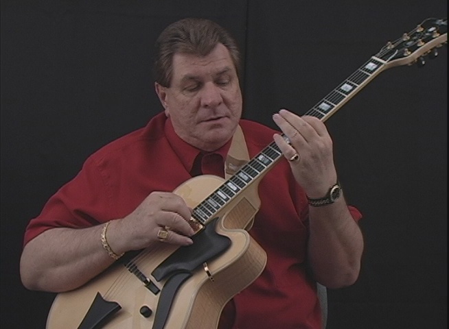

I still consider myself a NEWBIE to video editing and everything that goes along with it. I am shooting these instructional DVDs and am having fits trying to figure out how to get the image I see on the computer monitor and the image I see on the TV screen look at least somewhat close in terms of brightness, etc..
Here is a frame capture from last night's shoot. I don't know if it helps, but I read that a Television's color temperature is 6500K, and I found I was able to adjust my computer monitor to that setting with its controls, yet once again, the image on the computer monitor is sooo much darker and dreary compared to the same picture I am viewing on the TV... Isn't there a way to sucessfully calibrate the TV and monitor to approximately the same setting and then try and find a happy balance between the two?
DVDs that I rent in the video store don't seem to have this problem THAT much...

Every TV is different. We have TVs in our studio that cost over $1000 and their primary purpose is for color correction only. I would reccomend getting your screen calibrated and then going from there.
"I would reccomend getting your screen calibrated and then going from there. " how do I do that correctly? and how do I know when it's right? IF the tv and computer monitor are both correctly calibrated, will the picture look somewhat close?
A qualified Video Service Technician can properly calibrate your monitors.
However be advised that CRTs require periodic re-cal due to aging.
Look in the yellow pages for a local tech.
CRT Calibration falls into four major areas. Color Temperature, purity, convergence and linearity.
Once calibrated the CRT should not be moved. -
Computer monitors and Televisions have very different gamma values. With both calibrated for their stated purpose you will get much darker colors on the computer.

nope. 2 different types of displays. i recommend the ol' tried and true "trial and error" methodOriginally Posted by sdsumike619
make a few quick samples of the vid and burn it on a dvd. try it in every tv in the house. and keep the one that looks best on average. because it's gonna look different on every single one of your customers tv's
For best results you should be making quality judgements on the video (TV) monitor. You didn't mention your editing software.
Products Like Sony Vegas and Adobe Premiere allow real time monitoring on a video monitor. Usually the monitor (TV) is connected through a camcorder so the hardware DV codec in the camera can be used to generate the video output in realtime at full quality.
Cheaper programs often don't have this capability. ULead Video Studio 8 will allow DV playback from the timeline to the DV camcorder. You can also use free apps like WinDV to playback sample DV streams back to the camcorder.
The monitor (TV) must first be calibrated to a DV reference color bar. Most editing apps provide these. In order to properly setup a TV as a monitor, all automatic color correction features should be switched off.

I think the important point in the original post, that no one has addressed yet, is that the DVDs he is creating show much more variability than commercial DVDs. Everyone is talking about calibration, but I don't see how that would cause his DVDs to look different than commercial ones.
Another related issue for NTSC DVD authoring is management of 7.5 IRE setup.Originally Posted by sync
DV format places black at 0IRE. The DVD format calls for black to be authored at 0 IRE. An NTSC DVD player will lift black to 7.5 IRE at the output. This is where a commercial DVD will display black.
The TV monitor needs a different calibration for authoring (at 0 IRE black) and DVD playback (at 7.5 IRE black). This is one reason why it's a good idea to encode a color bar when authoring a DVD. The color bar can be used later for proper monitor adjustment.
Another problem related to NTSC capture is double setup. If you use a DV camcorder to capture NTSC, it will record setup directly placing black at 7.5 IRE *. If this isn't corrected during capture or authoring, the DVD will be encoded with 7.5 IRE black and the DVD player will lift black another 7.5 IRE for a total of 15 IRE (i.e. 7.5% too high). This will make the image appear overly bright and washed out (no blacks).

Absolutely not. Graphics card NTSC out is notorious for poor levels and non linearity. While it is possible to calibrate a monitor to a color bar on this output, it will often produce misleading results on the actual DVD. Best practice is to use the DV out for monitoring.Originally Posted by rhegedus
A graphics card will only pass what is on the monitor display. The video shown on the monitor will have 0 IRE blacks and if used for reference, will produce a DVD that is too bright and washed out.
PS: I see rhegedus is in the UK. Setup management is a NTSC issue. In a PAL environment blacks will be maintained at 0 IRE during capture, authoring and display. The graphics card video out will still be non-linear but at least it will display the correct black. -

It's a 5+% vs >2% tolerance issue.
Camcorder DV codecs (hardware) produce broadcast quality specs. Graphics cards use very cheap D/A and NTSC/PAL encoders that produce wide tolerance.
Also the NTSC/PAL signal that appears on the graphics card S-Video out is often a conversion from the RGB display buffer and several conversions distant from the raw video being monitored.
The DV output is monitoring the actual signal.
