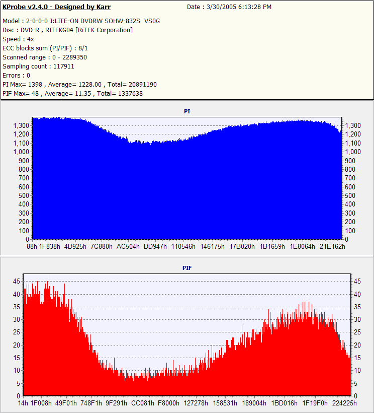

    I just finished transferring all of the Ritek G04 burns I made last Spring. Most of these were burned on a Pioneer 107D, some were burned on a Liteon 812S, and some were burned on a Panasonic E-50. All of these media had Kprobe scans with PI in the low 100s and PIF in the acceptable range. My Liteon was brand new so I scanned everything.
    I now find that virtually all of these media show scans with PI and PIF 5 to 10 times higher. None of the other media I have burned at the same time (Prodisc S03, a few Princo) have shown any degradation. All media was stored in dark and cool.
    If "short term media degrading" is a myth I would be happy to accept some new term for what happened here.

    It is easy to blame my scans on a "deteriorating drive" if you want to. I suppose if you are determined to defend your position that there is no such thing as media deterioration, then phases of the moon is a viable defense as well.
    In this case you need some other explanation to dismiss my media deterioration as I have nothing but great scans on other Ritek media burned in the same period.
