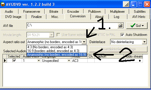

    make sure you set anamorphic when selecting res.
  3. Thanks for the answer, I was hoping that was the case, but what is anamorphic and where do I set it
  4. I wonder if your source is 23.97FPS then by converting it to 25FPS instead of 29.97FPS wouldn`t that give you a higher bit rate video and fewer dropped frames.
  5. it's in the aspect ratio setting
