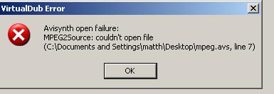

  11. Ok, so I have got a step farther, see if I am right, I basically write up the script in a text file, save it with an extention of .avs and open it in virtualdub. So this is my script:
    ## 1080i Source to XviD output
    LoadPlugin("C:\plugins\MPEG2Dec3.dll")
    Loadplugin("C:\plugins\FDecimate.dll")
    LoadPlugin("C:\plugins\TomsMoComp.dll")
    LoadPlugin("C:\plugins\BT709ToBT601.dll")
    LoadPlugin("C:\plugins\UnDot.dll")
    MPEG2Source("D:\2005-03-30(Wed)PM0903-CHD22.tp",cpu=0)
    Trim(1,2)+Trim(2,3)+Trim(3,4)+Trim(4,5) #Modify with actual ranges
    TomsMoComp(-1,5,1)
    FDecimate(rate=23.976,threshold=1.0) #Modify threshold as needed
    crop(8,6,-8,-10)
    LanczosResize(1280,720)
    BT709ToBT601()
    UnDot()
    and here is the error I am getting
    and if you check out line 7 you will see that, I have tried putting all sorts of files there, mpeg from HDTV2MPEG2, demuxed .d2v and the raw .tp file any thoughts?
  12. Ok, I got it to work, just changed line 7 to DirectShowSource("C:\SmallvilleIntro.mpg")
    but now it looks even worse than before with just using generic DVX, can you suggests any good scripts out there.
