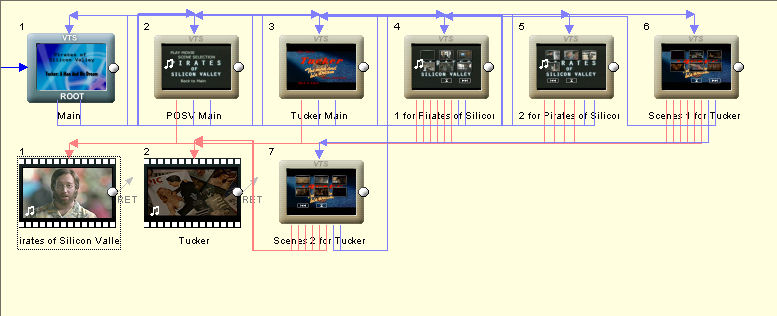

Could you post a shot of the connections window as well, just so we can see how you have structured this.Read my blog here.

Anyway, I have included a shot of my connections window, and i will try to just rebuild the dvd and see waht happens.

I don't know for sure but I don't think you should have arrows (connections) that point against each other as in your screen shot. That might be sorta like an electrical short- it pops a breaker every time.
That type of connection is valid. Imagine a main menu that points to a scene selection menu that has a link back to the main menu. It can be presented either as a loop, or as arrows running against each other. Regardless, the construct is valid.

My tip is to start again from scratch. (Reboots option 3)
