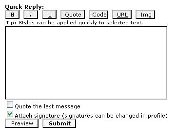

  6. Thanks for all your suggestions, sorry it took me so long to respond. I was finally able to restore it from a backup and now it works fine. Like you said PHP seems to be very touchy. The forum is working great except for one thing. I installed a MOD, Quick Reply with Quote and BBCode but instead of looking like this:
    It looks like this:
    I've even double checked the code but it still doesn't work correctly. Any ideas?

    Don't really have an answer for you on that one. I would suggest, if you haven't already, getting an account over at phpbb.com since the mod designers are over there.
  8. Originally Posted by Flaystus
    Yep I have an account, but that is a mod from phpbbhacks.com, something not "officially" supported by phpbb, but that works fine with it and is widely used.

    Garibaldi, I too had problems with that particular "quick reply" MOD
    Only thing I could get to work was "quick_post_es" from phpbbhacks.com
    other than that, check your lang_main.php file...make sure all entries are on a new line, and separated with ;
    and check your *tpl files for any "wierd stuff"..
    I too am new to this phpbb thing, and am learning lots of new things...PM me if you want to trade any "secrets " or see what I've done with my forums...
