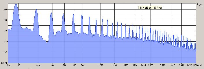

  1. I have an old recording from a church with a very annoying noise (I think there were microphones hanging from the roof) that I haven't been able to remove so far. I checked the file in Sound Forges Spectrum Analysis (screen shot attached) and there is a repetitive peak that comes every 100 Hz. I've never seen this kind of noise and wonder anyone know how I can remove it? Perhaps there's some "special" plugin to eliminate it?

    I am not convinced that the peaks in your diagram are the noise you are trying to remove. They look suspiciously like the harmonics from a pipe organ (http://www.pykett.org.uk/how_the_flue_pipe_speaks.htm).
    Is there organ music in the audio sample? If not, can you describe the annoying sound? Is it like a buzz, hum, static?

    tdan: I'm sure it's not a pipe organ because it's there many times in the same recording but with different level (and it don't sounds lika a pipe organ).
