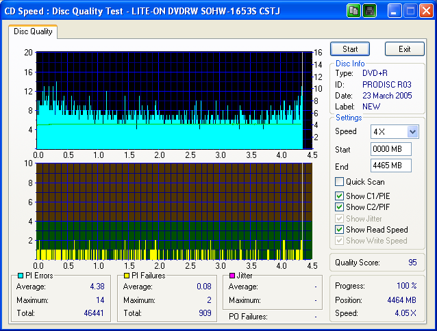

    here is a burn scan of my prodisc r03 burnt on my litein 1633@1653 cstj note i only burnt at 6x as thats all the firmware likes for the media
