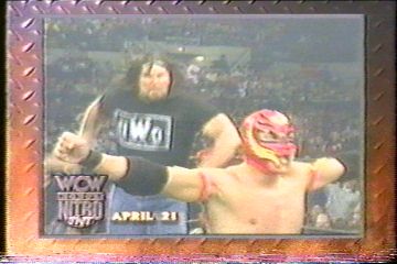

    I have a JVC HM-DH30000U VCR, and have noticed that on certain tapes the video will play back too "hot". The whites are much too bright, and the captured video cannot be adjusted to look properly with any PC tools.
    There seems to be no rhyme or reason as to what tapes playback too hot. All different brands and lengths have this problem, as well as tapes recorded in a variety of different VCRs. It does not do this on any commercially recorded tapes however.
    Anyone have any clue as to why this might be?

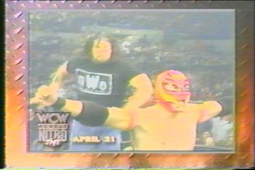

    * The same tape, played in another VCR through the JVC VCR will improve somewhat, but is still too bright. Playing the tape in another VCR hooked directly to the television shows the image properly.
    Here's a screencap of one of the tapes in question. Yeah yeah it's wrestling, I know...

    Here's the same shot on a $30 VCR playing through the JVC unit.

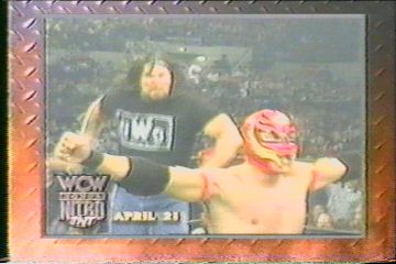

    Can you show us the same screen cap directly from one of your vcrs that doesn't have the problem (just for comparison purposes)?
    Here is the same shot coming directly from the $30 Panasonic VCR

    I don't see a problem with the JVC at this point. Both images look like crap, the JVC and the Panasonic.
    That's just a horrible tape.

    Ok, I never said I was working with master copies in SP speed here... but I mean, there is a very obvious quality difference between the first and third images. The $500 VCR shouldn't playback worse than the $30 one. And this happens on hundreds of tapes I own. I'm trying to figure out why. This was just the tape I had on hand to show an example of what I was talking about.
    The JVC unit is too bright and oversaturated. I can live with the image from the Panasonic. The problem here is that I shouldn't have to settle if there's a way to determine the problem with the JVC.
