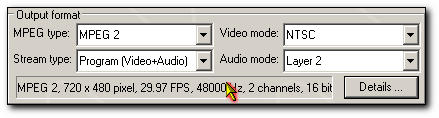

Chrissyboy...as long as you set the output in MC to DVD (NTSC) ...you will always get an MPG of 720 x 480...regardless of the seetings for the actual video that were set in Crop and Scale.
I have the output set to MPEG 2 because that is the only way to do 23.976 with a 3:2 pulldown in mainconcept. So my question is what should the video settings be in the details menu and in the crop & scale menu? They can be different. If I am understanding correctly I should set the video to 720 x 480 under the details menu and to 576 x 384 (if you keep the proportions) in the crop & scale menu. Is that right?
In my version of MC. If i choose NTSC DVD then 720 X 480 is set in stone. Can't be changed. If this is not the case for you then yes set up 480 first, then scale.Do you mean that I should first set the resolution to 720 x 480 and then go into the scaling menu?

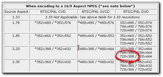

Halm: 384 comes from https://www.videohelp.com/guides.php?guideid=360#360
the source ar is 2.22 so 720x388 is in fact 384....SVCD2DVD v2.5, AVI/MPEG/HDTV/AviSynth/h264->DVD, PAL->NTSC conversion.
indeed. That is what i am saying. you will always get the correct resolution, the scaling resolves the egghead effect.Originally Posted by HalmSVCD2DVD v2.5, AVI/MPEG/HDTV/AviSynth/h264->DVD, PAL->NTSC conversion.
ok. override the video width & height to be 720x480. Then do all that was mentioned before.Originally Posted by csmedsrc
and don't use keep proportions.SVCD2DVD v2.5, AVI/MPEG/HDTV/AviSynth/h264->DVD, PAL->NTSC conversion.
giving:
OK I understand now. I'll make sure I don't check the keep proportions box. I'll report back when its done, hopefully it will work this time.
