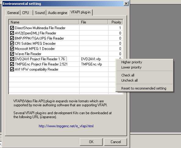

    Everywhere I read that you just load the DVD2AVI file into Tempgenc and go. But my ttempgenc will not recognize the file format DVD2AVI produce.
    Do I need any plug ins or is there an obvious thing I have missed?

    Try this ...
    Go to Option > Environmental Setting > VFAPI Plug-in, right-click on DVD2AVI Project File Reader and go to Higher Priority. Repeat until it's at the top of the list. Then try to open your d2v file.
    The other thing to remember is that you must keep the VOB files intact - you can't just delete them after the D2V file has been produced, as it references them.

    thanks for the quick reply.
    With your picture I realized that tempgenc doesnt come with the DVD2AVI project file reader installed. Where can I get ahold of this?

    There should be a file called DVD2AVI.vfp which I think you need to put in your TMPGEnc directory.

    It shouldn't need to go in the TMPGEnc directory. Always worked fine for me in the dvd2avi/dgindex dir.
    In DGIndex/DVD2AVI under help, make sure that VFAPI is ticked.
  6. I'm a MEGA Super Moderator Baldrick's Avatar
    try dgindex instead of the old dvd2avi.
