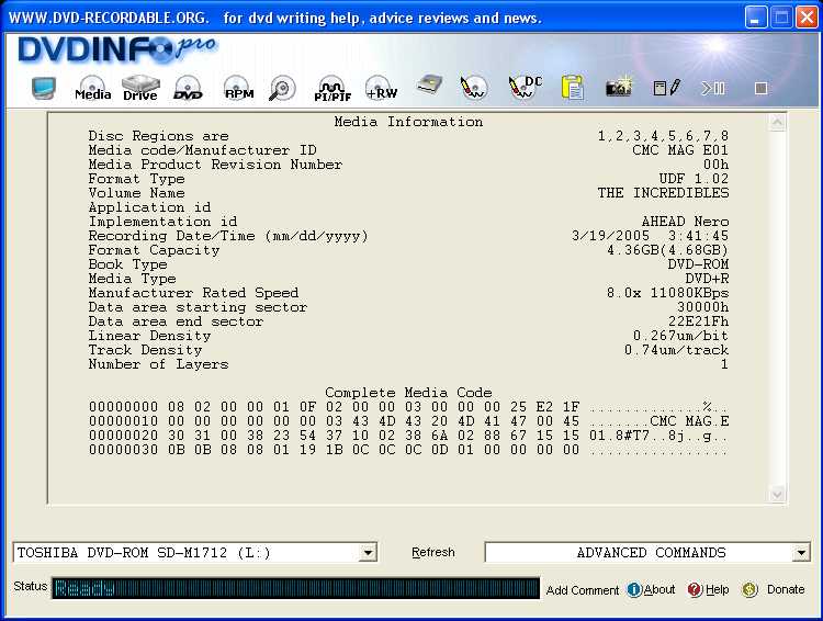

DVDInfoPro
Will tell you if it is "+" or "-", what regions it was encoded as 1 through 8 (prob. all region as i have yet to see a burned dvdr encoded to any one specific region
), if it is "+" booktyped to DVD-ROM, manufacturer of that disc, what it was burned with......

As far as i have ever seen "silver" dvd's are pressed not burned.Originally Posted by shira
I would like to see a screen shot using DVDInfoPro like the one i posted.Originally Posted by shira
Only a dvd+r can be bitset to change the booktype to dvd-rom,Originally Posted by shira
That is why i would like to see a screen shot from DVDInfoPro,
All you have to do is use the little camera icon at the top to save a photo & then you can upload it here.
