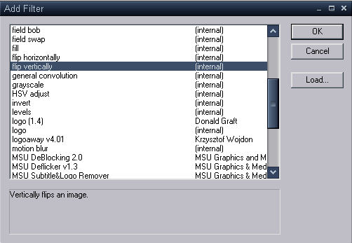

Can't you rotate video in virtualdub????
I would imagine you wouldn't even need to mess with the sound...
Kevin
EDIT - Yes - go to VIDEO - FILTERS - ADD - then select "FLIP VERTICALLY"Donatello - The Shredder? Michelangelo - Maybe all that hardware is for making coleslaw? -
I check VirtualDub ver1.5, nothing there indicating rotation (flip) of video.Originally Posted by yoda313
Unless I don't see it. -
Open virtualdub,click on video/filter then add filter.
