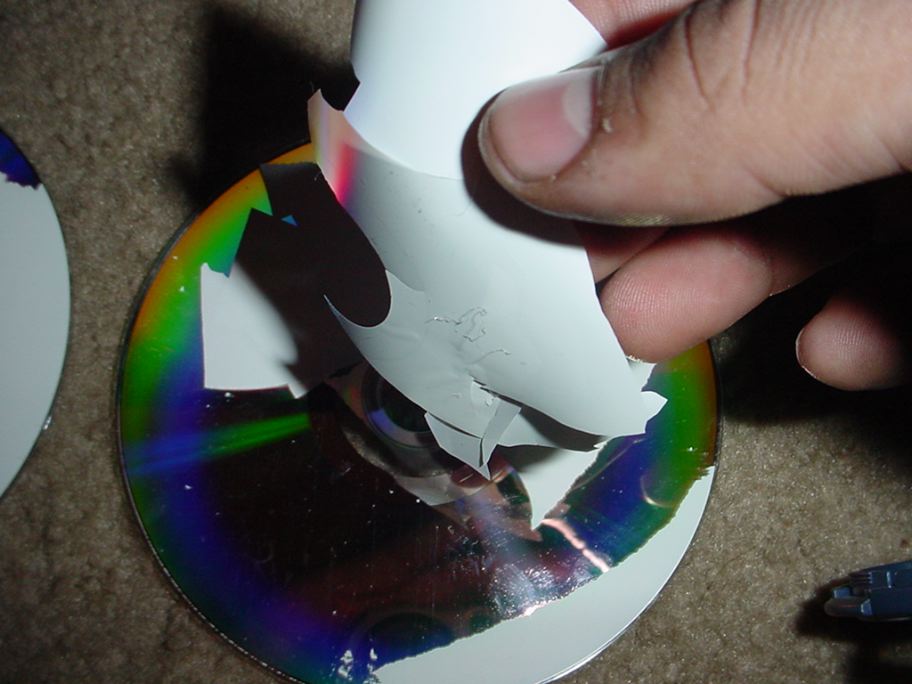

    The labels on a printable DVD arent really paper though. Yes, it can come off...but it's much thinner than paper. It's more like a painted surface. Here, look at this.

  15. Hmm looks a little different than the one I saw but ok.

    Yeah... i was gonna say, any of the printable dvdr's i ever saw were definately not covered by any kind of "paper"
    printable cd-r's either.....

    The only "paper" looking printables I ever saw were early EARLY generation 2001 LeadData. Those did not last long, but the media did work quite well. The surface had grains, almost like recycled paper.

  19. I see what you mean now. I scraped up one of mine to take a look at it.
