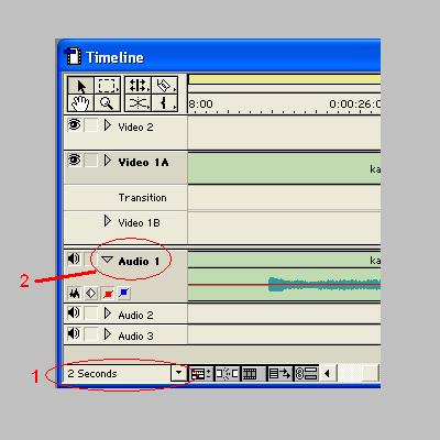

Hi Marley_,
Adjusting audio volume (and left-right balancing) is quite straightforward in Premiere 6.0 onwards. I use Premiere 6.0, and the following screen prints are taken from there. Later versions are probably similar...
I'm assuming you have put the video clip on to the "Timeline" - just drag from the "bin", and drop into a video track. The associated audio will display in an audio track.
1. Set the timespan of the timeline to 2 seconds or less. This will allow you to see the audio's waveform. Any more than 2 seconds and it's not displayed.
2. Click the audio "Collapse / Expand Track" button to display / hide the waveform. Viewing this will allow you to judge where to edit the audio better.
In the middle of the waveform, you'll see a horizontal red line (if the red button on the left of the timeline, in that audio track, is clicked - if not, click it). This is called the "rubber band" for the audio's volume. As it's in the centre, it's 100% (i.e. normal) volume. It can go down to 0% and up to 200%.
Adjusting the volume is done by clicking (once) on the red line to establish what's called a "handle". The handle can be dragged up or down to increase or decrease the volume's percentage.
To do fine adjustments, in increments / decrements of 1%, press and hold "Shift" then drag the handle. Dragging the handle to beyond the waveform will delete it. Handles can also be dragged left-right to adjust their position in the timeline.
In the image above, I've set a handle at 100% to establish an end point for the preceeding audio. The very next frame then has a handle at 0% and the volume will gradually increase (as per the gradually rising red line) back to 100%.
This will have the effect of suddenly stopping the original audio, then fading it up from silence to normal.
NOTE: By default, there are immovable handles at the beginning and end of the audio clip, so if you want the effect to start at a certain point, you must place a handle there or the effect will start from the beginning of the audio.

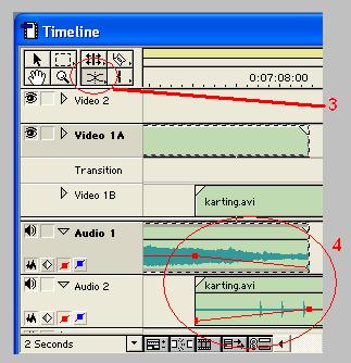

If you have two audio tracks overlapping, you can click on the "Cross Fade Tool" button (item 3 in the screen shot below). You then click on the first audio track (the cursor will change to the same as the button you've just clicked) and then click on the second audio track.
This will have the effect of fading out the audio track that's playing first, whilst at the same time fading in the subsequent audio track. See item 4 in the screen shot below - it's self-explanatory.
Play with it to figure out how to achieve what you want.
