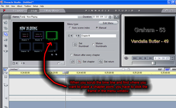

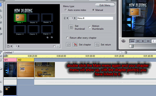

You can see I've already added some chapter points, but basically do what it says. make sure the menu is selected. If you use a motion menu, the menu itself will appear in the lower track and must be selected before you can add chapter points. If you use a static menu, the menu will appear in the same track with your video clip and you simply need to double click it select it.
Now scrub the timeline to where you want to add the chapter point. Once you find it, single click the chapter frame in the toolbox window.

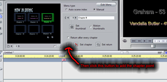

Click the add chapter button and that frame of video will show up in the toolbox window.
Now if I'm way off on this next section...well, I don't have anything else to do so.....

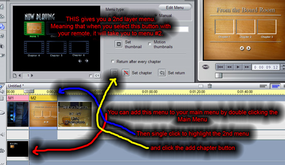

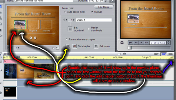

I was a bit confused by you 2nd post. If you only want one main menu option, but want chapter points throughout the video as you watch it, you need to add a 2nd menu. I'll have to explain this, but basically you do what I say in these 4 pics, just don't add the 2nd menu to the main menu. You will add the chapter points to the 2nd menu. The only chapter point you need in the main menu is the beginning of your video. You will make the chapter points in the 2nd menu, but leave it off the main menu to just skip through as you watch the movie. If you want a scene selection menu too, then just follow the pictures.
I picked a static menu for the 2nd menu and the process to add chapter points to it are the same as in the first 4 steps above.

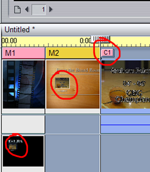

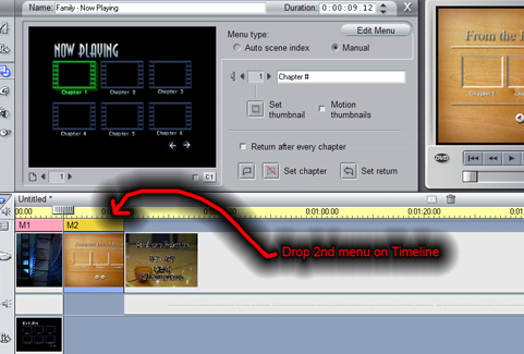

Although I'm giving this to you in a little bit of a reverse order, I suggest you add all your chapter points to the 2nd menu before add it to the main menu.
same as the 4 pics above, just with a sub menu. But as I was saying earlier. Add all your chapter points to this menu, you can create as many pages as you need. As I said, if you want to link to this menu from your Main menu that's up to you, the chapter points will still be there and will still be functional. Although I personally don't see what a scene menu hurts but it's your video and you know what you want.
This is of course if you want a scene selection menu.
If not...
Both the Main menu and the sub menu are linked to the same chapter point, in this case...the start of the video. Just add the rest of the chapter points to the 2nd menu and if you don't add the 2nd menu to the main menu, then the only link will be from the main menu to the start of the video, but you will still have chapter points throughout the video. Also make sure in studio that you set the return to return to the main menu, that is very important if you chose not to show the scene menu. Otherwise you video may return to the scene selection menu and you may get stuck with no way out to the main menu. So just set the return to return back to the main menu and life will be good.
Hope this helps. -
