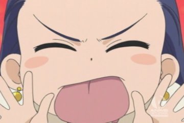

Attached is a screen shot from one of my captures.
It's posted for comedic effect.
:P
Image Details:
Screen Capture from Petite Princess Yucie. (Anime, Children's)
Captured from The Amine Network On Demand. (Time Warner iControl)
Resized in Paint Shop Pro 7.
Reduced in size by 50%.
Converted from bmp to jpg.

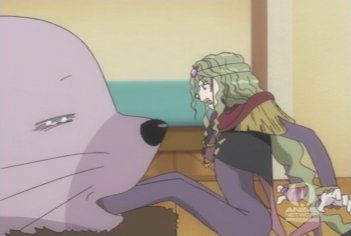

Another goofy screen cpature:
