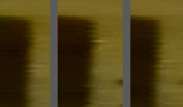

  9. Originally Posted by Fos
    I used a jvc Hr-s7700 for playback the tape wich is vid(2)[ Master->copy->copy] with the DNR/TBC ON .
    The line TBC should have gotten rid of the little timing errors. For example, here is a 8x enlargment of a crop of the top right corner of the doorway near the center of the screen in the first part of the video, three consecutive frames:
    As you can see, what should have been a nice straight vertical edge has become jagged and wavey -- and it changes with each frame (the camera was still during this sequence). This kind of problem absolutely kills MPEG.
