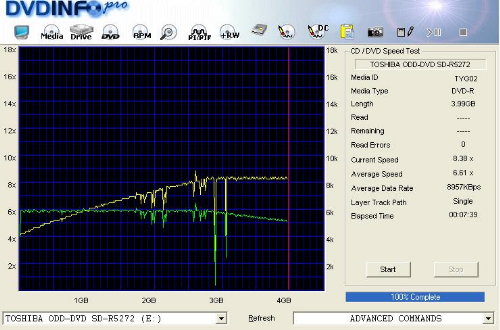

  14. DVDInfoPro was used to id these disks. They come up TYG02, same as the original poster except these are a plain silver color with no writing or writing surface. It is limited to one per customer. The sticker on the bulk pack said $29.95 for the 50 pack but it rings up $12.50 at the register.
    Their prices on other brand media is pretty good right now too. Both TDK and Fuji X8, dvd-r at at $9.95 for a 25 pack.
    A few of these disks have been burned on a Panasonic DMR-E75V. All worked fine. They have been tested on a Toshiba notebook, SR-D5002 and SR-D5272 internal drives, and a Sony NS725P dvd player with no problems.
    The price does make one wonder if they are fake Taiyo Yuden, but why would they fake TY and not other manufacturers product?

  16. My feeling about the GQ media is mixed. Earlier some of these disks were burned on a Panasonic DMR-E75V in 2 hour mode with a tape a little over an hour long. The results played on several players. The Panasonic does not fill the dvd-r in two hour mode if there is only 70 minutes of material however.
    A new burn was done with the Panasonic in Flexible Recording mode in which it is told how long the recording will be and it adjusts the bit rate to fill about 4 GB of the disk. This disk was tested using DvdInfoPro for speed. The result is below.
    It indicates a problem out about 3 GB. Four dvd players were tested at the point of the two anomalies. Two units ( Sony NS725P and Toshiba SD-R5272 with Sonic CinePlayer ) played perfectly. The Panasonic which burned this disk had large blocks in a moving person at the first anomaly and froze at the second. The Toshiba notebook with WinDVD fared the worst. At the position of the first anomaly, it began to skip from chapter to chapter and did not recover.
    Verbatim and Ritek disks did not show any anomalies of this size. I would not recommend this media if it is important for the disk to play in a variety of players.
