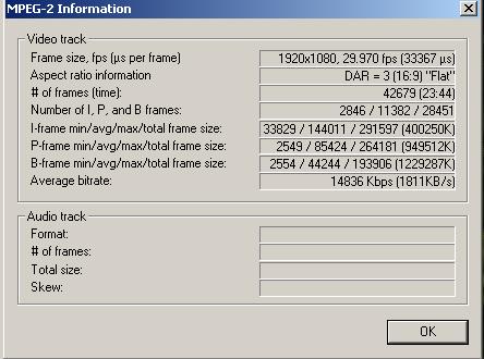

I am having trouble converting a hdtv transport stream with all programs, but I am trying to get virtualdub mpeg2 to work, I have used hdtv2mpeg to convert the origanal file, but here is the file info that virtualdub gives. The show says that it is ac3 5.1 audio.
I also installed the ac3filter from sourceforge, but virtualdub still doesn't see the audio.

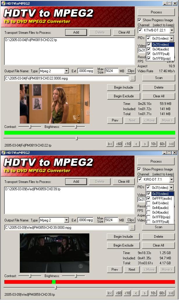

Ok, here is some more info, I had some samples on the hard drive of some hd sources and tried turning it into a regular mpeg2 with hdtv2mpeg2 and they work having the audio and everything, this is frustrating, here is a picture, the top one works and the bottom one doesn't, but look at the options to select from on the one that doesn't work. Does this give any hints?
A couple of ideas:
Run it through this: http://users.adelphia.net/~mwilczyn/mpeg2repair/
See if you can demux it in Pvastrumento (you'll need to rename the .tp extension to .ts)
Also, dgmpgdec https://www.videohelp.com/tools?tool=DGMPGDec will demux the audio on Transport streams.
BTW, that PID address of FFFFFF for audio is weird. -
