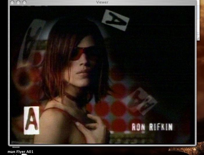

  8. Member terryj's Avatar
    N35°25.24068, W097°34.204
    Hmmm, Something is very amiss.
    Here is a picture of a capture I just did of an Alias
    DVD build for Season 4 I'm working on:
    and you'll notice the DVD Player is in the Background,
    and I sized the Capture Me window wider and over
    the picture ( you can see the edges).
    Click Once to capture to the desktop,
    open the file
    in Photoshop or Graphic Converter, and voila there it is.
    and it doesn't matter encrypted/non-encrypted.
    here's retail version of Spider-Man 2, cop car chase scene:
    So you might try it again, it does work.....
