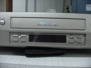

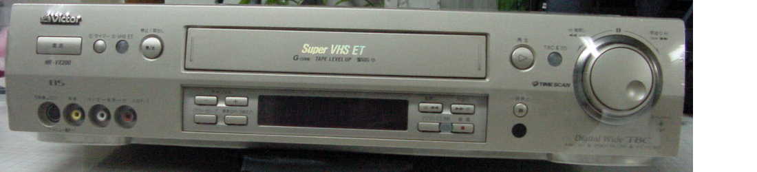

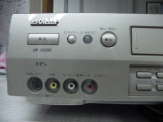

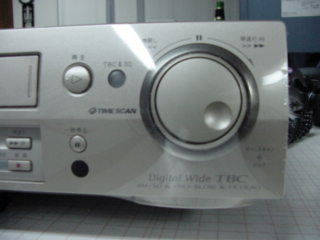

Well, I left this sit at the store for 3 weeks and I couldn't leave it there any longer. I passed on this same model months ago here. I basically sacrificed my new CPU for this. I believe this is a Japanese version (I'm in Japan) of the JVC HR-S9XXX series. It doesn't look like 9911 but it bears a striking resemblance to the 9800. What I need is help identifying it (not that important though, I already know it is a high end JVC with 4MB TBC & Digital wide TBC). What I really need help with is the menus. If someone could post the menu structure of one of thses VCRs I'd really appreciate it. I've noticed the Japanese versions of stuff usually has the same menu setting except for the BS set up here. Here are some pictures:

Actually, it looks more like a 9600 to me...
Here is the 9600 manual link (.pdf)
http://books.jvcservice.com/download/622107567/19556.pdf -
It can only be the 9500 or 9600.
The 9600 will have all the menus shown here:
http://www.digitalfaq.com/capture/vcrtbcsuggestions.htm
(see bottom of page)
The 9500 will be missing some of those filters.
Then again, if it's all Japanese .... maybe you can't read that either.Want my help? Ask here! (not via PM!)
Yeah, I may need to have it translated. My menus don't exactly line up with the 9600 manual. I forgot about the manual. It's a little beat up but it was in the bag...
*edit* Yeah, I think this is a 9600. I can tell that what I am messing with is the video calibration. I think I have another option (other than on/off) under my Digital R3 menu though. Does the 9600 have a third option there? -
