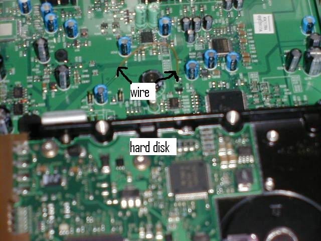

I had 1 of each and found no difference. I would tend to go with the newer manufacture date though, since there are probably some circuit and mainboard modifications.
That is the only differance I noticed on the few I have looked inside of. If you look closely there is a little wire on the top side of the main board that has been sordered there on the july one that is not there on the oct one.Originally Posted by Guitarman
Could that have fixed the whining sound that recorded itself from the front inputs?
Probably not. The buzz from the front inputs is from the ribbon cable for the inputs being to close to the display they are using in the recorder. The display is not LCD, and is causing line noise at the inputs.Originally Posted by solidsnake
I think it had more to do with highmat whatever that was. I found that many of these with that wire had a sticker on the outside of the box that said highmat fixed. Like they where sent back and refurbished.

What wire? Now I have to look for that. I was trying to avoid it but I can't. -
Sorry for low quality pix. My son has my digital cam so had to use web cam. But you will see where to look.
Thanks for the pix. I agree, what is highmat? What does it do. I guess ilo knows they fixed it, but why? What was the problem that the unit should not have? Is this on another forum? The HRo4 that I have doesn't have the wire
