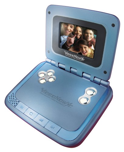

VideoNow XP shows up on Amazon.com as being shipped on August 15th. You can preorder now. It has a folding form factor that looks like a cross between a DVD player and a Nintendo DS without the second screen. Looks like it will retail for around $75.
No wonder the regular units were being cleared out. -

BTW: I never heard the XP version until you mentioned it. I don't know the quality ... but I think they are moving out of their market. Frankly ... I think they should sell the mini discs and a package of software that helps you make your own stuff.
Just an aside, does anybody remember the hand held game system, Game.com, from Tiger/Hasbro? It had some really great games, a touch screen and voice synthesis. Unfortunately it was in black and white and not backlit. So, does...
VideoNow XP = Game.com + color + backlight + VideoNow Color?
