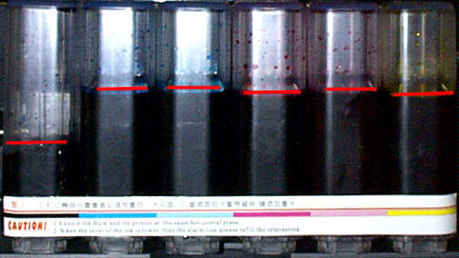

And here is a photo of my tanks after about 200-225 dvd's and somwhere between 75-100 full page covers being printed.
I have went through mostly black because most of what i print is mostly black
I am just refilling for the first time today, just the black.
I had a good portion of air in my tubes when i first installed it but after 2-3 head cleanings they were sucked out and never had a problem since ??
If air keep's going back into the tubes i wonder if there is an air leak somewhere ??
