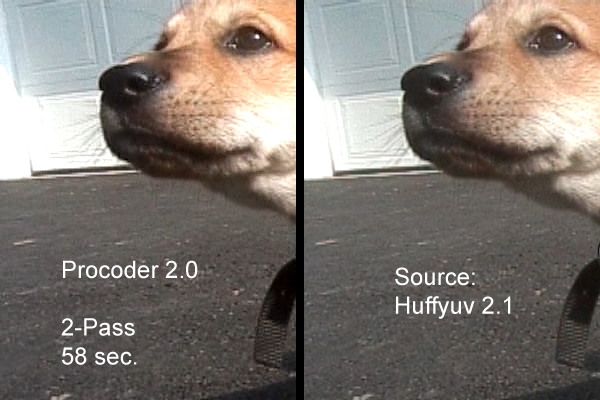

1st test: Procoder 2.0
You can see in the light areas of the picture that Procoder completely blew them out to pure white. Not a good thing if you like detail.

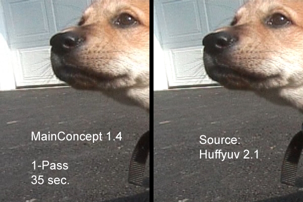

3rd test: MainConcept 1.4
MainConcept also did a good job coming very close to souce and it did it right in only one pass. MainConcept never really needs more than one pass.

But having said that, the MC pass looks pretty good. -
I have always been an advocate of MC single pass. Fast and good.

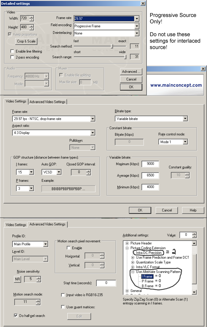

Before this thread gets locked, let me post the detailed settings I used in MainConcept 1.4 encoder. In case anybody wants to do some comparisons.
* Note This was a progressive source and these are settings for Progressive source only.
odd settings a bit for a dv source -- to begin with , removing the interlacing ... and why such a high min. rate ? and you didnt check 16-235 and DC for MC @ 6500 would be better at 9 (minor thing)
based on the one image above - you might want to set Noise Sensitivity higher -- hard to say w/ only one still frame ..
Procoder doesnt blow out whites -- so either an error was made in conversion in AE or you didnt select the correct levels in PC"Each problem that I solved became a rule which served afterwards to solve other problems." - Rene Descartes (1596-1650) -
It's true, it started off as interlaced DV. After processing in AE (Time stretching 200%), it essentually split it into seperate fields effectively deinterlacing it.
The same thing could be acomplished with Avisynth > Vitualdub, then use Deinterlace Smooth filter to make 60 full fps.
I just wanted to get nice smooth slow-motion effect and it worked out quite nicely.
I've tried the 16-235 and it makes no difference with the sources I'm using.
As for Procoder, it got feed the same source as the other encoders. It is possible that I may have missed a setting. -
