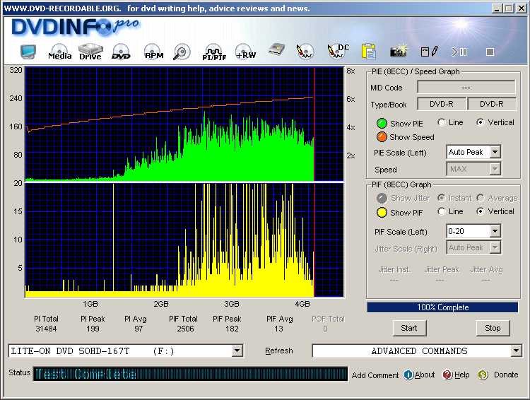

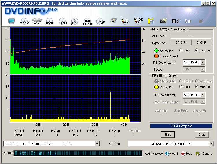

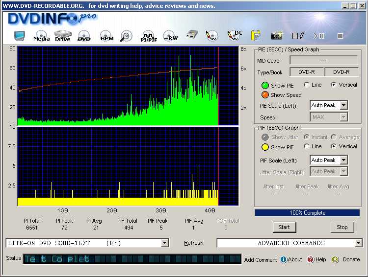

i have 3 scans of verbatim dvd-r mcc02 burned with nero6608 speed 4x,6x,8x.......
6x and 8x scans are TERRIBLE...
only 4x is acceptable..why?
my older pioneer 108 burned them better than new 109!!!!
test reader liteon sohd-167T....
there is first scan verbatim mcc02 burned 4x....

deejay, scan at 4x, and I also second Fandim, I've had a little better luck with Nero CD-DVD Speed. 4x is the 'standard' more or less for doing PI/PO tests.
Your 4x burn looks OK, nothing great but certainly far from being a coaster. Your 6x and 8x scans look like crap for what is supposed to be good media, but they'll probably play back ok. I do agree that they should be much better than that, though.

I tried to burn sony's 8 speed dvd-r 4x 8x also and not so much big difference in scans
are much better and the same almost
...but VERBATIM MCC02 first quality media burn terrible at 6x and 8x.on pioneer 109...why?
pioneer 109 does not like them? -
