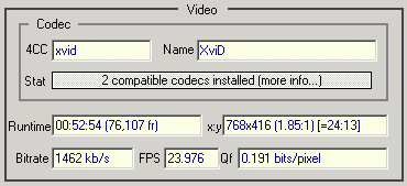

xinjingqiao,
Use GSopt to open your file. You should see something like this. (See screenshot)
The 4CC code will identify the codec required. Also displayed will be the name of the codec. Load that codec pack on your system. That should solve your problem.
