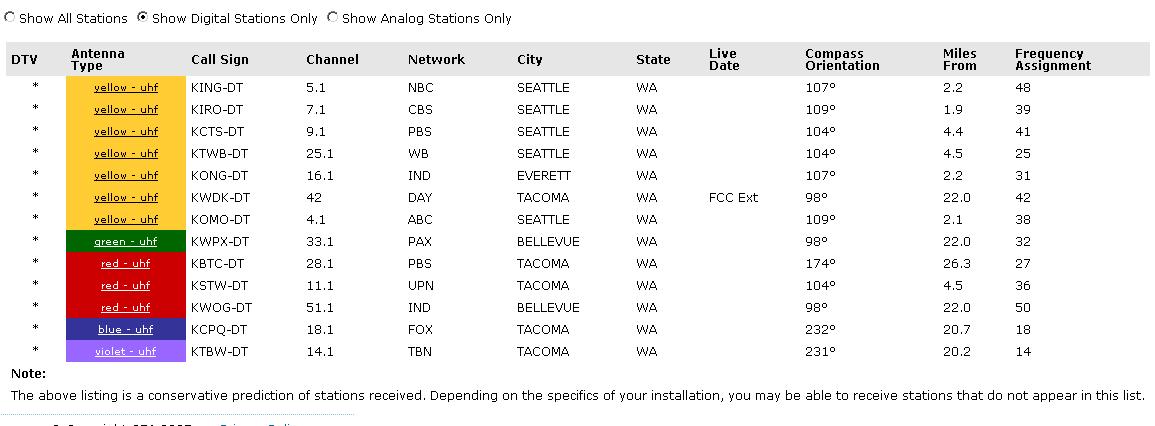

I am back, Ok I have figured out that I can get cash for my gift certificate and I am going to go for the dvico card for $150, that seems pretty reasonable. Now my problem is an antenna, the same website that redwudz suggested for the card has this one http://www.copperbox.com/lite/popinfo.php?lc_code=HDTVi&uneek=2914803
, but does anyone have suggestions, I am in seattle and have quite a selection of channels but will be moving soon where there are quite a few less and will want a strong anntenna. -
Go to http://www.antennaweb.org/ to find your local DTV stations and the direction and distance.
That site will make antenna recommendations based on your actual street address and stations you want. Sometimes an internal antenna is good enough, sometimes you need multiple large rooftop antennas. Sometimes hills prevent any reception.
Keep in mind that many DTV stations are not yet transmitting at full power. The AVS local HDTV forums are good to access the local conditions and antenna requirements. -

ahh, I didn't realize they just used regular UHF antenna, I don't think it will take much to get the stations where I am at currently,
. But when I move I know it will be.
You should be able to get the Yellow and Green stations with an indoor antenna. The lower ones are predicted to be more difficult because of distance, transmitter power or obstructions.
