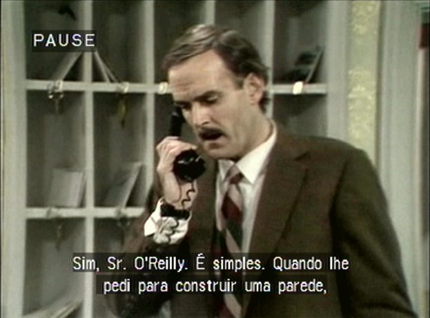

  7. Here is a screen shot from the latest "official" firmware from Philips (0112). Latin1, Latin2 and Cyrillic have been renamed to CP1254, CP1250, CP1251. Subtitles now have the semi-transparent background used as the only choice. Font appears to be Arial narrow.
    Firmware is for Philips 630 and is compatible with 642/37, though not 642k/78. It likely has macrovision which was introduced in November, and probably isn't any improvement on Huffyk's or Bruno's 0531 modified firmwares
    See this thread for modified firmwares
  8. When just one text line is displayed, does it show a second empty backgrounded line below the text line as it happens with modified versions and with remote control trick?
  9. Javier, no it doesn't show 2 semi-transparent lines if there is only one subtitle line. It shows only what it needs. However it still doesn't support code for bold or italics, [b] [i]. It just displays it as subtitle text.
