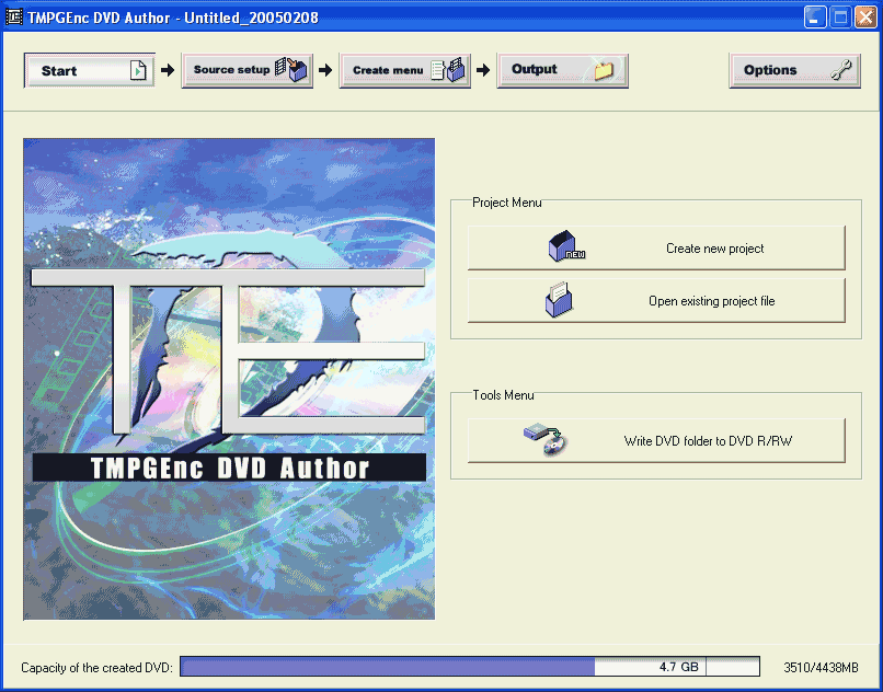

Launch TMPGEnc DVD Author and click on Create New Project button.

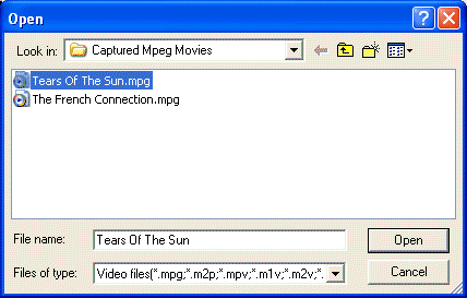

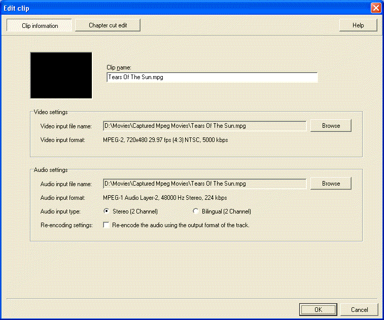

Click on the Add File button and open the Mpeg file you want to convert.
Note: Your file must conform the the specification as outlined under Supported input files at this link:
http://www.pegasys-inc.com/en/product/tda_spec.html#a1

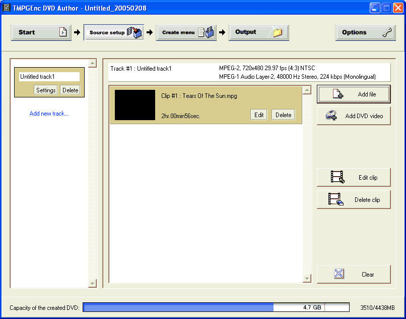

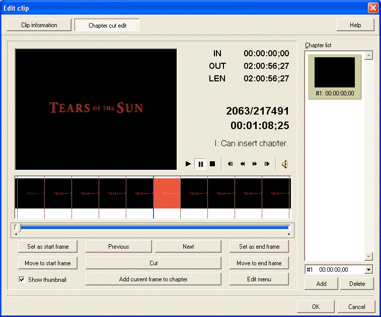

This will bring you to the Clip Information window. This gives you all the information about your file
If you need to edit the file by removing frames, click on the Chapter cut edit button and edit as required.
If you don't need to edit or have completed the editing click OK.
This will bring you to the Source setup window.
Click on the Create menu tab. If you need to create a menu, do so. For the purpose of this guide we have selected no menu.

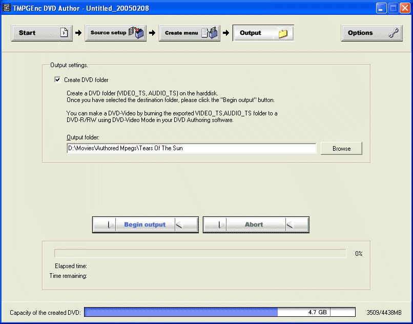

Click on the Output tab.
Select an output folder and click on Begin output. This will convert your Mpeg file to DVD.

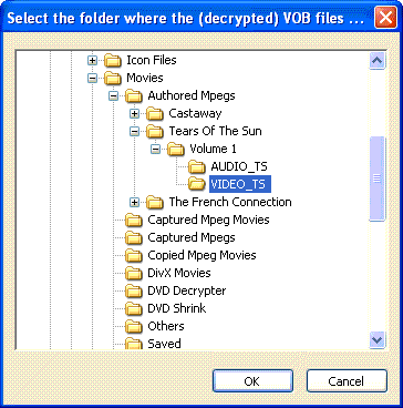

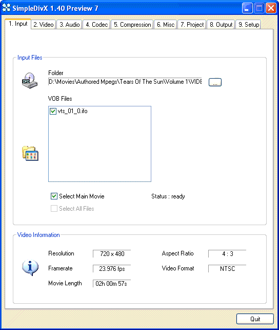

Launch SimpleDivX.
Under the File tab, click on the browse button to the right of Folder and browse to the file you created with TMPGEnc DVD Author.
Click on the video file.
Click on Select Main Movie

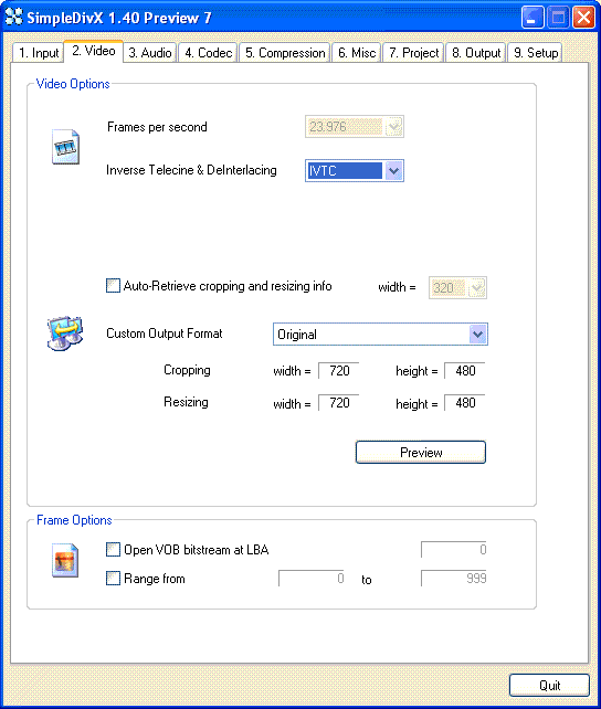

Click on the Video tab. Under Inverse Telecine & DeInterlacing select IVTC.
If your file is from a burned commercial DVD select None. You can preview if you like.

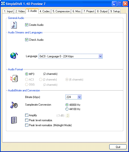

Click on the Audio tab. Be sure Create Audio and Check Audio are checked. Select the desired Audio output.
I recommend using the same audio as the file.
Select your audio bitrate and samplerate.

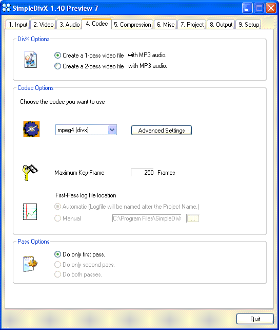

Select the Codec tab. Select Create 1 pass if MP3 Audio and mpeg4 (divx) or Xvid.

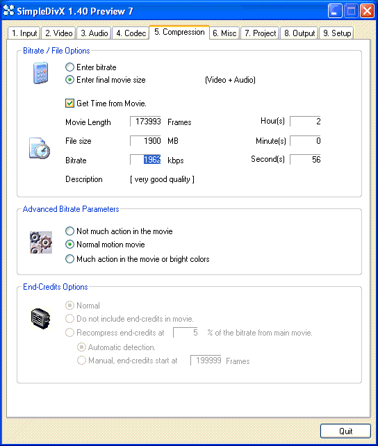

Select the Compression tab. Select Enter final movie size and Get Time from Movie.
I have select 1900MB for the file size for best video and file sharing. You can also convert to a specific bitrate. To do so, click on Enter bitrate and then enter the desired rate.
Select Normal Motion Movie. I have had very good luck with this setting even with lots of motion and bright colors.

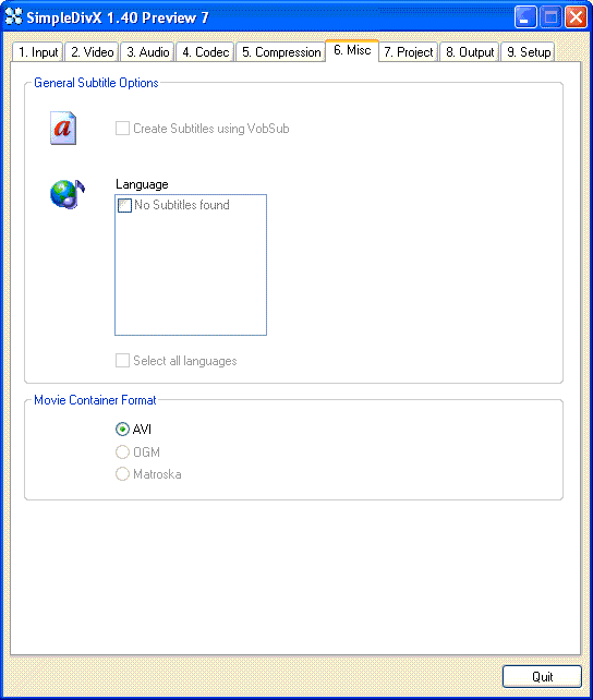

Click on the Misc tab. Nothing to do here.

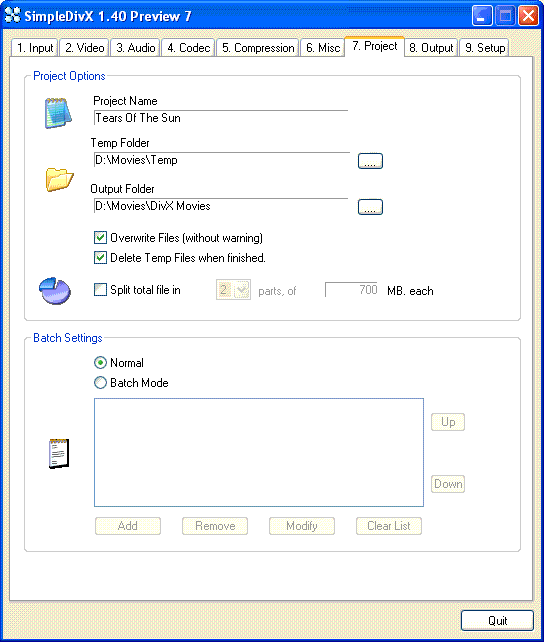

Click on the Project tab. Under Project Name, select a name. Under Temp Folder, select a file for temporary files.
Under Output Folder, select a folder for your DivX file.
Check Overwrite Files (without warning) and Delete Files when finished. Leave split total file unchecked.

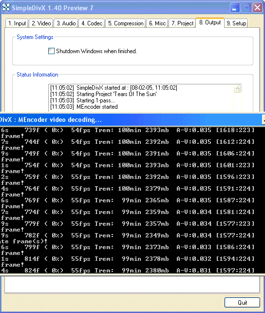

Select the Output tab and start your conversion by clicking on start.

A problem with this method, which is visible in this guide, is that SimpleDivX has a bug causing it to mistake the incoming frame rate. When I capture a TV program to Mpeg2 it is 30fps. Tmpegenc DVD Author converts this to a VOB that is still 30fps. But SimpleDivX opens the VOB and reports it to be 24fps, just as shown above.
That seems to work OK if the source material was a movie. In the example above, IVTC is selected, which should output 24fps. But when the source material really is 30fps (like a sports event), then the output will be a jerky 24fps. There is no solution for this, as SimpleDivX has greyed-out the pull-down box where you are supposed to set the fps rate.
I hope this will be fixed in a newer version than the current 1.40.11. Until then, Tmpegenc 3.0 Xpress does a good job of making this conversion in one step (no VOBs). But it's not free. -
