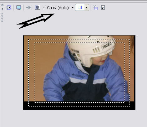

I appreciate your help on that last image, but.. The Quality setting tab for the preview window cant be it.Uber-Moovie Noob -
So... Am I screwed? The only difference I see in the Preview windows is the "Display" but I'm clueless is to what the problem could be... If you have a possible suggestion.. I've been checking to see if I have had any replys in the last 1-3 days.. Seems that everyone is out of ideas we well... Unless you have a suggestion!

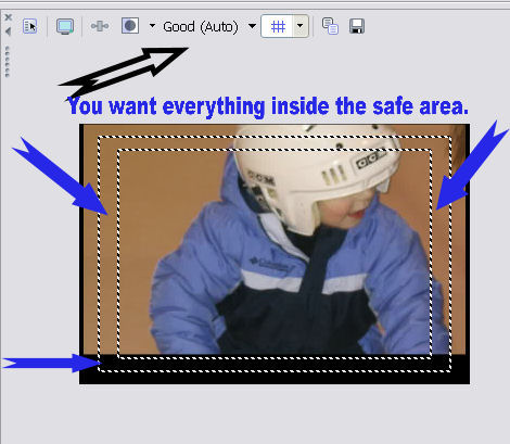

Sure I want everything inside the safe area.. although I do not know how to get it inside the safe area.. nore can I read any Text (Font Size 20 is what it is at and it is unreadable unless the preview is at (Full)). I never had this problem before... I want to get the text legable, a somewhat big preview window, and have it all inside this 'safezone'.. What do I need to do?
Edit: Timeout.. When i render the video.. the video feed from OUTSIDE the "Safe Zone" is shown.. This is getting to my head and Im starting to think It'll months to figure this out which is usually the case when I ask for help..
Edit 2: I moved the slider things and that allowed me to make more room for the video.. I 2x clicked on it by accident and I was wondering... How can I get that to appear again?Uber-Moovie Noob -
I think I have figured it out on my own.. I just moved the Sliding things that allowed me the determine the size of the "Edit details" Preview window etc.. I found out by just dragging the slider, it sized up to the way it was supposed to be. Thanks for the assistance canadateck.

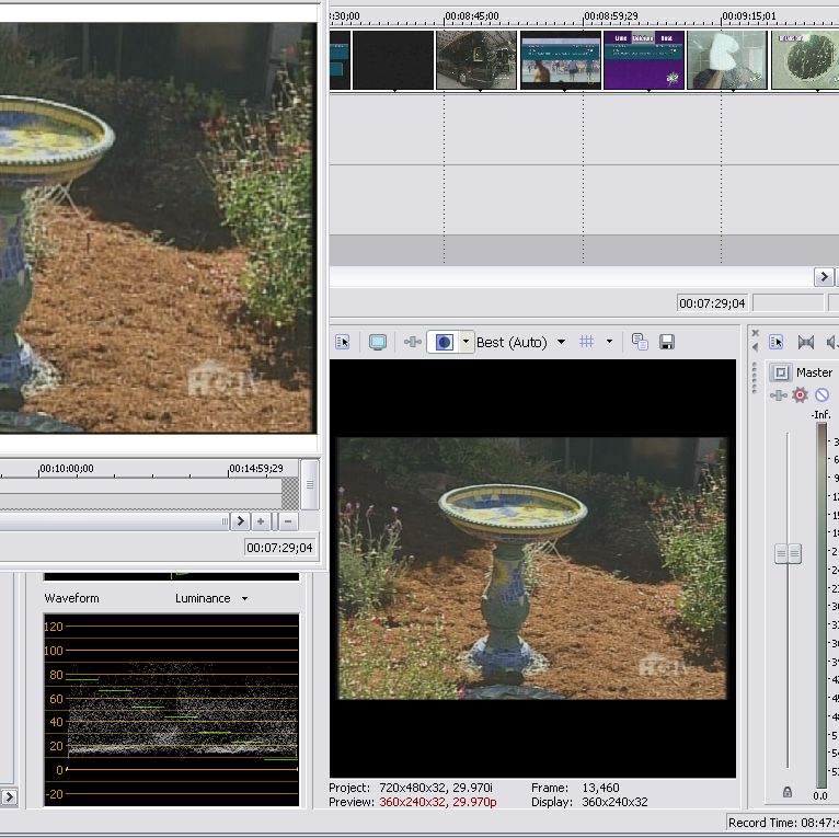

When in auto mode, try resizing the monitor window for the resolution you want. High resolution will be cropped unless you drag a larger window. Here is a half size monitor window using best auto. 360x24x32. Make it bigger on the desktop and you can see 720x480x32.
