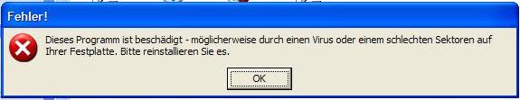

    Bad news everyone today my Riva FLV encoder died, all i get when i run it is this error thats written in a foreign language maybe ill grab a screenshot of it and post it on here. OK i took a screen grab of the error and here it is its attached to this post
    Feb 2006
    Can someone tell me what this error means, im thinking maybe it was a piece of the program that my virus scanner flagged as bad but why would it do that, the only word that i understand out of this error (I speak english) are programm, Virus, and Reinstallieren <-- im thinking this means reinstall the program so i tried that and it didnt work, well im now using super (c) and i can convert most FLV files Directly into iPod videos, havent tested them on the ipod they play in quicktime, they are just a couple of sesame street clips from youtube and a tv commercial, oh and does anyone know what codecs that myspace uses b/c i cant convert their FLVs with riva or super(c). i think tom patched that to allow saving but not converting, God i hate DRM

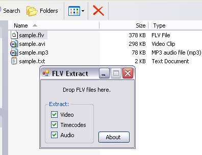

    To get the file into VirtualDubMod you must first demultiplex it. This means to separate the video and audio into separate files (streams). For this process I recommend you use FLVExtract v1.2.0. Download and install this version because it will also work FLV4 files.
    FLVExtract is a simple one box program. You open Windows Explorer to the folder containing your FLV file then run FLVExtract. FLVExtract stays on top of explorer. You simply drag and drop your FLV file onto FLVExtract and it will automatically demultiplex it to the same folder. The video will have a file extension of AVI, but it will still be an FLV. The audio will have an MP3 extention (most likely).
    FLVExtract in the foreground with Windows Explorer in the background: I drag&drop sample.flv onto FLVExtract and it created the streams and the text file. The video stream has the extention .avi, and the audio extention is MP3. The text file is .txt.

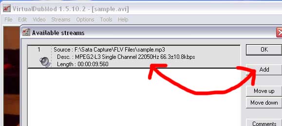

    Now that I have my decoder enabled in ffdshow and my FLV file demultiplexed I am now ready for VirtualDubMOD.
    Run VirtualDubMod and load in your demuxed FLV video stream (in my case it's sample.avi). Next click "Streams" then "Stream List" then when the box opens click "ADD" and select your demuxed MP3 audio. It will look like this:
    Next comes a simple conversion to HuffYuv AVI. Huffy is looseless so you loose no quality in the conversion. The filesize will be large but after this step any of your encoding/editing program will be able to open and work the file type. VirtualDubMOD is a cool program because you can add filters at this point and clean up the video. You can also filter the audio to some extent in the program. You can resize your FLV also in this step, or you can just do the simple conversion to Huffyuv then do all that other editing later.
    Click Video - Compression - Select Huffyuv from the list of available compressors (if it is not there you need to download and install it), then click OK.
    I also recommend you convert the audio if you are planning on later going to DVD with this file. So once again click "Streams" then "Stream List" then Right-Click your audio stream and select "Full Processing Mode" (because VDM was going to simply stream copy - not convert - your audio), then right click the stream again and choose Conversion. Now choose 48000Hz, 16bit, High Quality, and Stereo. Click OK. Again Right Click your stream and choose compression then choose PCM, then OK the streams list box.
    To summarize. We set ffdshow to decode our FLV. We demuxed our FLV using FLVExtract. We have loaded our demuxed video and audio streams into VirtualDubMod. We set the video to convert to Huffyuv avi codec. We set the audio to convert to DVD specs and to convert it to PCM (no compression wav).
    Now export your huffyuv avi by clicking File - Save AVI. Give it a new name and go. You should now have a new file that will play in any of your programs.

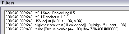

    If you decided to filter and/or resize, etc then you can close-reopen VDM (to clean your changes back to default) and load in your new huffyuv file. I have tried a few different filter arrangements and types but these seemed to work ok. Heres a photo of my filter list. If you don't have them a quick google search will find them easily.

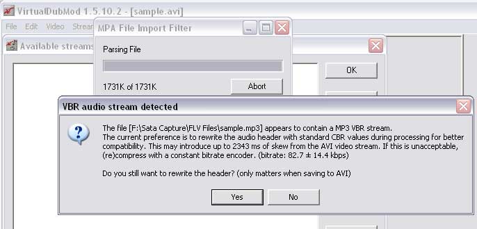

    Things that can make this process a little harder are:
    VBR (variable bitrate) mp3 audio
    This requires full processing mode to pcm in VDM. (just like above). Using my above steps should work ok. As my sample.flv file had VBR mp3 audio and it converted in sync. When you add the vbr mp3 audio VDM will pop-up a dialog box stating such, and since we are going to avi in this conversion selecting "Yes" to this box should be fine.
    The error message is written i german. It means that your program is corrupted, possible because of a virus or a bad sector on the HDD. Please reinstall the program.

    IF AVIMux_GUI reports the .mp3 audio file as a VBR then you will get A/V sync problems with some players*
    Load the .mp3 file into 'lamedropXPd' and it will make a .wav file of the audio**
    Load the .wav file into 'lamedropXPd' and it will make a .mp3 (CBR) file of the audio
    Mux the video and CBR audio with AVIMux_GUI to make an .avi
    this .avi is now playable in media players (you may need 'ffdshow' to view if you don't have the correct codecs AND this .avi is easily loaded into 'VirtualDub' and can be converted into the format you desire)
    *the problem was some of these files obtained were VBR and converting them into Divx to play on my DVD media player caused A/V sync errors and other problems ... making the audio into CBR and using AVIMux_GUI (over VirtualDubMod to remux) fixed this
    **set lamedropXPd to "restrict encoder to CBR" and target bitrate of 128
