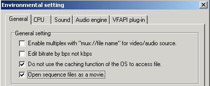

Also, using TMPGEnc, how would I encode a movie that was broken into two or three .avi files with ac3? It seems that I can only do one file at a time. Is there anyway to do all two or three files at the same time to ensure that they will all fit onto one dvd?

SEALs1230,
As for encoding multiple input files to single output file in TMPGEnc - select "Open sequence files as a movie" under Enviornmental Settings > General.
Make sure your input files are sequentially named as "File1.avi", "File2.avi" ... Load the first file to encode and start encoding. TMPGEnc will automatically read the next file and so on and encode it to whatever output filename you mention. Though the main screen will continue to show the first file as input. The output file will be one big mpeg file. -
