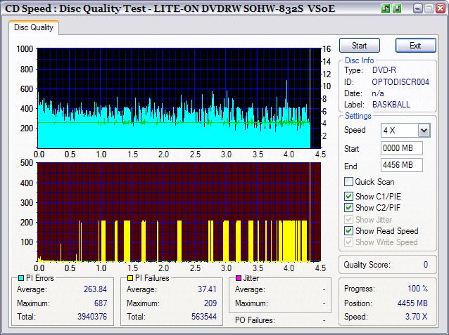

    Well, I've posted a lot of scans through the days, and thought some people might find this one pretty amusing.
    This is the worst scan I've ever gotten from an UN-DAMAGED disc burned on my NEC3500.
    Here goes it.
    Seth

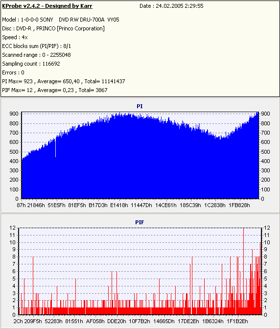

    But here's my circus of the day:
    A scan of Princo DVD-R, burned about 2 1/2 years ago. Ever since I got KProbe compatible burner, the scans from these discs were like that, so I wouldn't say that they are degrading or going bad over time. It's just that they scan like this.
    This Princo plays perfectly start to end on all my DVD players and I have absolutely no trouble copying from it using any of my computer DVD drives. I've had more trouble playing discs that had only half of PI values of this disc, but this one just keeps going. It's a mystery. Maybe it's doing OK because of the relatively low PIF values .
    EDIT: Sorry, the disc burned with Pioneer DVR-A03 (not Sony DRX-500ULX, which I didn't have back then yet). Still, never such a burn with DVR-A03 on other discs.
    Your "circus" is why scanning is only a portion of the battle. These "PI/PO warriors" online tend to miss the bigger picture, which includes accessing the data/video, as well as surface scans and read tests. (Don't take that the wrong way Fandim, I like to see your scan work.)

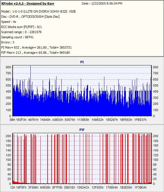

  14. If the PIF errors actually were as high as your Liteon was reporting, you'd never be able to even complete a transfer rate test and you'd never be able to extract the data, so the results are definitely inaccurate. A drive accurately reporting PIF levels of around 200 would FAR exceed the levels for a disc that could be extracted. Levels above 50 PIF are severely pushing the limits of a disc that can be extracted, let alone 200. So your Liteon is not accurately reporting the PIF errors.
    The transfer rate test would indicate you'd likely have some skipping issues in the last GB of the disc.
    Transfer rate tests with Nero CD-DVD Speed take less than 3 minutes (at least on some drives), and that's on a slower drive than yours. Differing programs, differing speeds apparently - they clearly do their tests differently than one another.
  15. Member Fandim's Avatar
    Jun 2004
    Reno, NV
    Steve - the test I ran has over 13,000 read errors.
    And to do an *accurate* rate transfer test (many programs have settings for this, for speed or accuracy), the disc must be read back 100%. Thus, it could not be completed any faster than you could rip the disc.
    I'm not vouching for the accuracy of the K-Probe, either. I just post the results I get. <shrug> I in no way endorse them. Heh. You've stated several times on some of my scans how awful my liteon is, and said how suspicious the scans look - and act as if I'm in some way preaching that these scans should be taken as the spoken word of god.
    Scans are just that - scans. The liteon obviously has the main fact of the matter right - this is a horrendous burn - 100% grade F coaster.
    And about your assumption about PIF errors, etc.. if they're over 50 - that does NOT always mean a readback error. If you check closely, you'll see my Liteon only has a handful of readback errors all total when performing a KProbe on this disc.
    Take it for what it's worth - if nothing else - you get to see how this particular media type scans on an 832. Heh heh.

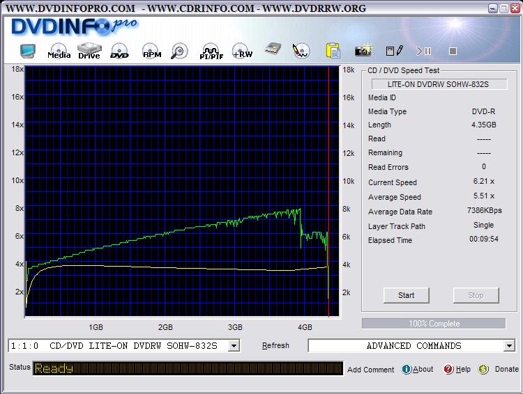

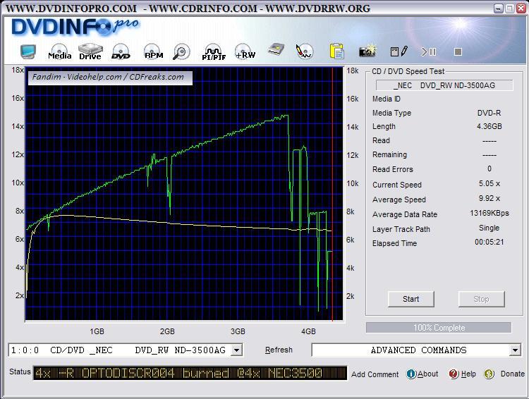

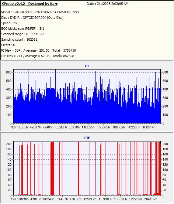

    Steve - these scans were ran back to back to back.
    Here is the KProbe, first.
    Next - the DVD Info Transfer test on the NEC. (NOTICE: It has 197k errors)
    Finally - the DVD Info Transfer test on my Liteon. It's able to fully read back all data. Yes, the drive that 'struggles' (as you put it) with the KProbe.
    Scans are a funky busines these days, eh?
