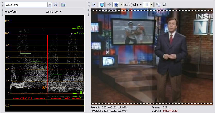

I can't speak to the Panasonic DVDR recorder and I haven't tried this in Virtualdub yet but here is what needs to be done to an improberly encoded MPeg2 with black at level 32. This occurs when NTSC (tuner, vcr, laserdisc, etc.) are recorded on a DV camcorder or DVD Recorder that assumes zero setup.Originally Posted by Cyrax9
Here is an analog cable channel captured through a DV camcorder. In this case the entire signal is shifted up in brightness 7-10%. You can see white clipping at 108 IRE (digital level 255).
Ideally the problem can be corrected with a negative 7-10% "brightness" shift. In other words, the entire waveform needs to be shifted down the IRE scale by 7.5 IRE nominal. This example needs a bit more shift due to incorrect cable levels as well. I'll correct it with the Vegas levels filter. Here you see the desired result. The picture shows the original on the left and the correction on the right.

The normal "washed out" NTSC capture problem is caused by 7.5 IRE black being mapped to level digital level 32.
I know nothing about the green shift problem on the Panasonic. Do you have any links?Recommends: Kiva.org - Loans that change lives.
http://www.kiva.org/about -
might be a timing issue --
All I did was shift the Y levels down 7.5%. That shifted 7.5-107.5 IRE down to 0-100 IRE for Y.Originally Posted by vhelp

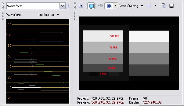

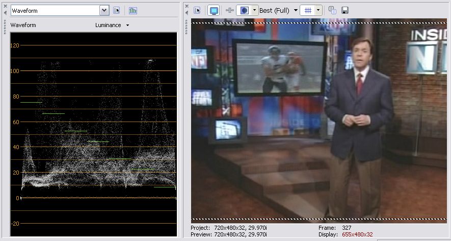

A waveform monitor is highly useful to sort this out. Depending on sources, the incoming video levels can be 7.5-100 IRE or like the cable box above 7.5-107.5 IRE. If the latter, all that is needed is a -7.5 IRE black level shift.
In the more general case the -7.5 IRE black level shift must be followed with a linear boost of Y gain to place whites up to 100IRE.

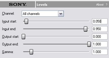

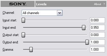

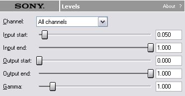

The Vegas Levels filter (Input Start setting) acts to stretch blacks down linearly without affecting white position. Input end setting stretches whites without affecting black.
I made this test pattern to show how it works. Left side is reference with 0,25,50,75 and 100IRE blocks. The Right side will have the filter applied.
Here I applied a -5%shift to black. Note that white stays put and gray levels shift down proportionately.
Here I applied a +5%shift to white. Note that black stays put and gray levels shift up proportionately.
Here I applied a -5%shift to black and +5%shift to white. In this case, 50% gray (50 IRE) stays put and white and black are stretched 5%.
