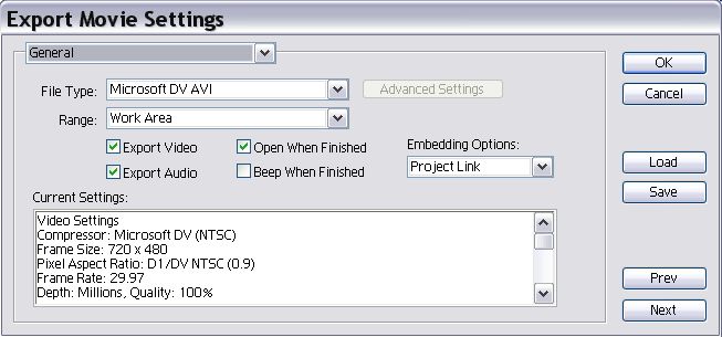

but on another note, I have tried some more things and this may give a better understanding of this problem or it may just give me a whole new problem. When I export the movie i go Export - Movie. But i looked in the premiere help files and it says that when I do that, it exports to Windows AVI and not DV AVI. So i tried to play the exported "Windows AVI" movie on another player (J Player) and it couldn't even open it. But it could open regular DV AVI fine. So I looked again in the Adobe Help Files and it said I could get it to DV AVI by going to Export - Export To Tape. But then i actually have to export to a tape! and I don't want that, i just want a regular DV AVI of my project! Can I somehow do this? Can someone please tell me how to if I can? Because I even tried to encode this "Windows AVI" export to VCD using TMPGEnc and it couldn't even read the video. So the final mpg file was completely black (no picture) but the audio was still there and it STILL sounded like crap. So I think the whole problem may just be this whole "Windows AVI" format that it likes to export to (it may be called "Microsoft AVI" but either way it's bad news). So i just need to know how to export to DV AVI. Any help on this would probably make my life, so thanks in advance. -

Under File, "Export Timeline", then "Movie" then look for settings.
The selection of file format for export is there.

I got an email from someone on this topic. You may not have gotten it also. It seems there is a bug in premiere where the audio gets added together and clips when 2 or more tracks are put into a dv avi file. Your best bet is to export to uncompressed avi or what I would suggest is to export your audio separately to a separate wav file.
