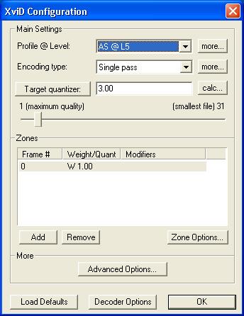

    I don't know AutoGK but it probably uses the standard XVID configuration dialog:
    Note the button labeled "Target Quantizer" near the top left. This button can also say "Target Bitrate". Click on it to change states. You must be in "Single Pass" mode.
