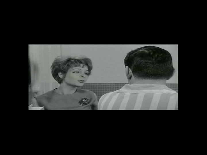

    This is a frame:
    I can see it right in the PC if a change the AR in virtualdub, as you said, or in any software player, but not on my TV.
    Dec 2003
    Spain
    Sorry for such a big image, but I didn't know well how to grab it.
    That distorted black and white picture is what I see if I let the original aspect in the software players.
    I see it well on TV after resizing to 384 x 288, but that may imply a lost of quality.
  5. Hi-
    1. No, judging from the picture, he resized it as if was coming from a 16:9 DVD, rather than from a 4:3 DVD as he should have. He most likely used the default 16:9 DAR in Gordian Knot.
    2. You can change the AR in many software players, or in ffdshow, but most standalone DVD/MPEG-4 players don't have that ability.
    3. All reencoding loses quality. I think you probably lost more than necessary because you downsized it. I would have made it 528x384, as the original encoder should have.
