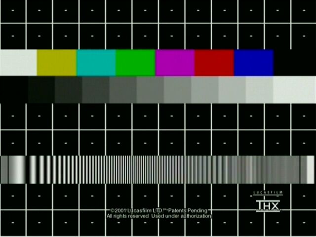

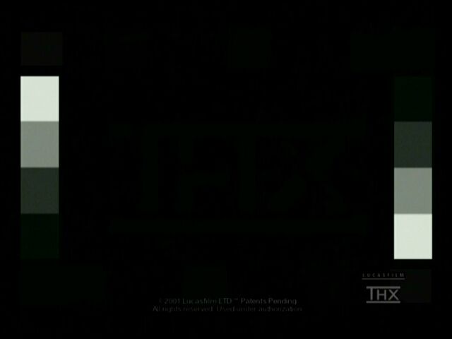

    Luma (contrast) pattern from the original THX DVD test disc:

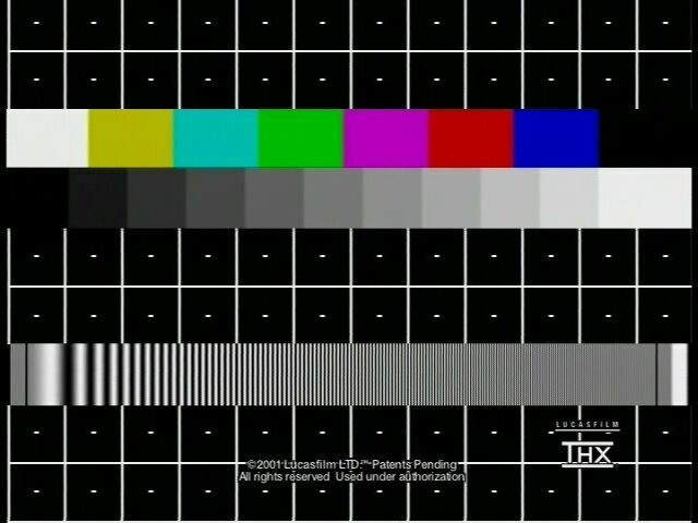

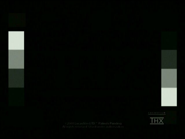

    Panasonic E55 recording, input "darker" and NR "on":
    Panasonic E55 recording, input "darker" and NR "off":

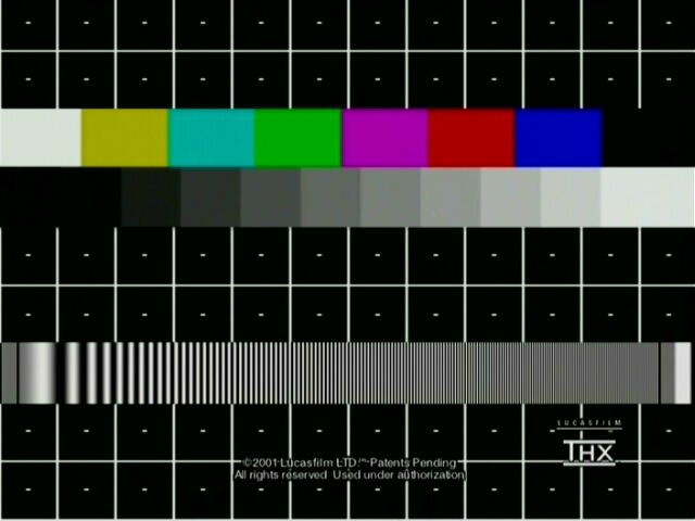

    Panasonic E55 recording, input "lighter" and NR "off":
    JVC DR-M10 recording
    Obviously, the "darker" input black level setting on the Panny E55 is not intended for a 0 IRE source... it is way too dark. The input video noise reduction feature does work, as you can see the two frames with the filter set to "off" have a bit more grain. The Panny recording with the input video black level set to "lighter" is still darker than the original THX DVD source disc. The JVC DR-M10 recording is the closest to the original.

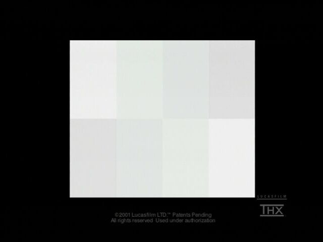

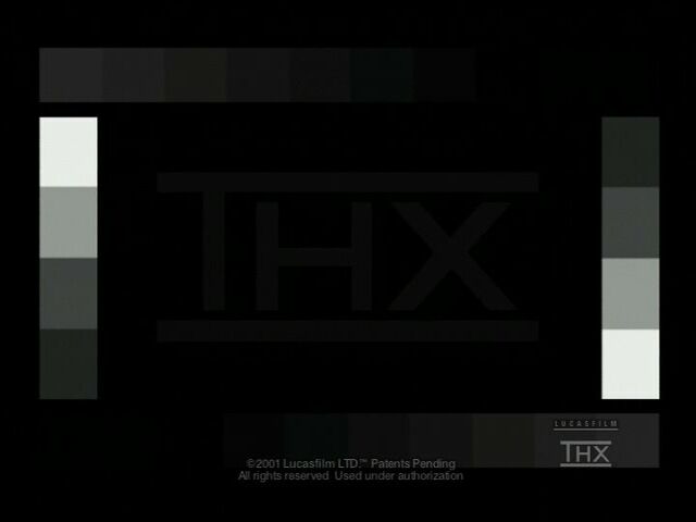

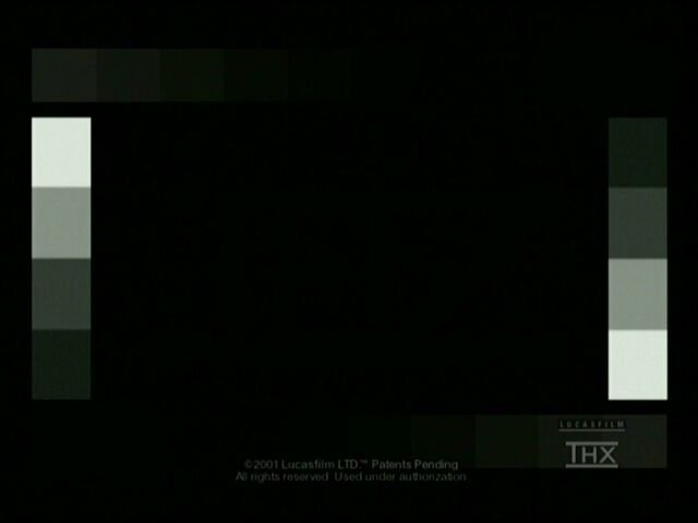

    Black level (brightness) pattern from the original THX DVD test disc:
    Again, even with the input video black level set to "lighter", the E55 recording is significantly darker than the original THX DVD test disc. The JVC DR-M10 recording is much closer to the original.

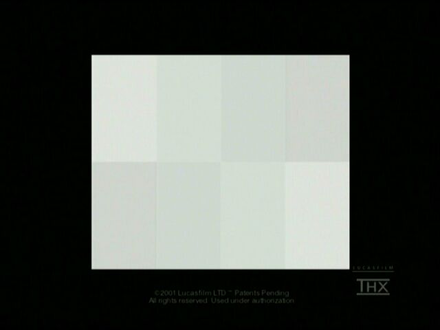

    Multi-purpose test pattern from the original THX DVD test disc:
    Again, the JVC recording is closest to the original (although a few pixels are cropped at the left and right edges of the frame). Notice something unusual about the Panny E55 recordings... the image is stretched horizontally. The vertical lines don't line up with the original as you move out from the center of the recorded test pattern. The JVC does not have this problem.

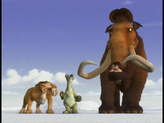

    Last set of frames, the Ice Age test clip...

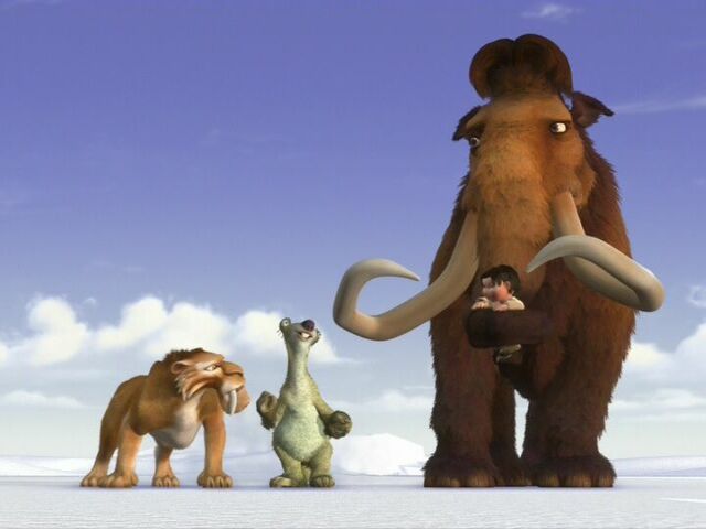

    Ice Age clip from the original THX DVD test disc:

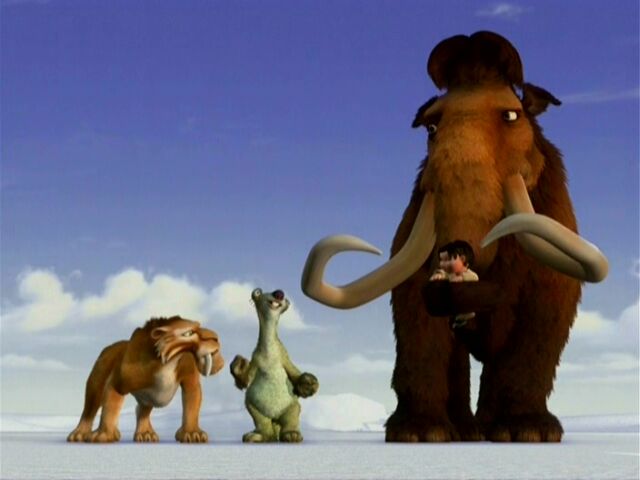

    OK, so I hate to sound like a broken record... but is there anyone out there still convinced that the Panasonic is superior in image quality to the JVC? The Panny recording is darker, softer, and significantly less defined than the JVC recording. That's obvious. The JVC recording is simply much closer to the original image on the THX DVD test disc, no matter how you look at it. Like I have been saying for months, if my Panny E50 had performed better than the JVC, I would have kept it. This E55 is no better than the E50, as far as I can tell.
    I need a DVD recorder that captures MPEG2 video that is as close to the source image I send to it as possible. The JVC does that for me.

    I've posted it before, and I'll post it again:
    After much research it has come to my attention that Panasonic is simply darker than it should be on encodes. That's the sole reason so many Panasonic fans think other machines are "too light" when it comes to image quality.
    I suggest that Panasonic has NEVER EVER fixed their IRE problems. What they have done to "correct" the issue is to allow the user to augment either the gamma or the luminance. Not the IRE. The results of such a change is that, while the "black level" is put to a darker tone, so are the lighter colors and whites. Furthermore, augmenting in this method would likely give the false appearance of "richer" colors, as darkening an image gives false ideal of "enriching color".
    When you augment luminance, and do it incorrectly, you often end up with "green shades" instead of black/gray shades, as is VIVIDLY and BLATANTLY obvious on the sample images above. It is also the sign of a horrible MPEG encoder. My theory is the DVD recorder uses a variation of the often-disliked Panasonic software MPEG encoder.
    That really solves some of the mystery of Panasonic image quality. A lot of it is false, and gives users false impression of other machines that can truly do a better job.
    There are a couple tricks that can help you minimize the damage (the the TIPS AND TRICKS thread), but it will never 100% correct these machines, not until Panasonic decides to entirely re-design the units from the ground up. They simply messed up so many years ago, and have been too lazy to fully correct their years-old mistakes.
    The result is a wholly inferior line of machines. Every model is this way. From the oldest of the old, to the newest of the new.
    "New age" equipment like JVC, Pioneer and LiteOn are better choices, when it comes to maintain quality, in terms of clarity, color/IRE/contrast quality, and noise-free encoding.

    I used my tool on your pics (just the first set of square ones) ...
    I found that your DR-M10 was pretty close to the original (as you inidcated) and I
    understand more so, you argument with its output quality capabilities vs. other
    units of name brands etc.
    As for your panns pics, I wasn't sure which one to pick. I think that the
    your fourth pic showed best quality (though dark as you indicated)
    I was just thinking, that your pics above could be used as a test guage (should I
    get *any* dvd rec) and perform similar tests from it.
