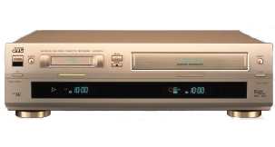

    Here's a picture of the HR-DVS1U combo MiniDV and SVHS machine
    That's a real brushed aluminum faceplate, all metal body... nice. $2K when new.

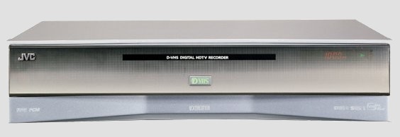

    Actually I have the 40,000.
    It is an incredible machine. First of all it does have a TBC (not sure why anyone would think it wouldn't...) and if you would go to JVC that info is readily available. It is an excellent, absolutely fantastic TBC. As for filters it has many filters for VHS, S-VHS.
    • Time Base Corrector removes jitter from fluctuating video signals (it really does)
    • Digital YNR/CNY improves signal-to-noise ratio by 3 dB
    The VHS, S-VHS playback is stunning on this device.
    There is no "button" as it is a sleek device. The settings are via the remote and menu. The TBC can not be turned off as it is a REAL TBC unlike regular JVC VCR's and it never makes the picture worse. The noise filtering and other filters can be manipulated.
    Having said this, the device is an HDTV recorder. This is its main function. Also I should say it is a full spec HDTV device, something that is very rare in the market right now. Most HDTV device are only capable of 1280x720.
    This device is 1980x1080 and it plays back VHS, S-VHS at 720x480 MPEG2 @9mb/s with PCM. For audio, D-VHS encodes Dolby Digital at 576 Kbps (compared to DVD's 384 Kbps and 448 Kbps data rates).
