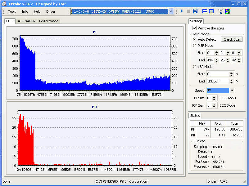

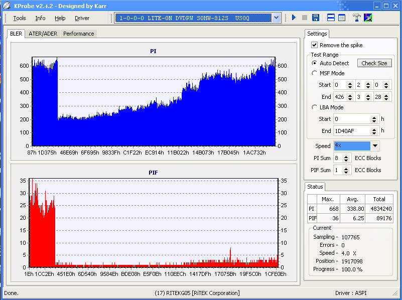

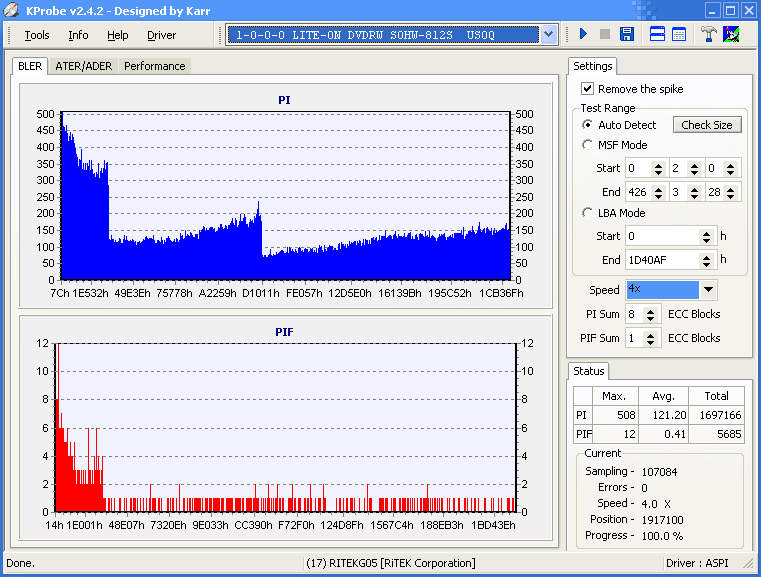

    Okay, i just got a batch of these from Rima.com atfer a sad batch of prodisc hub printable +R's
    Here is a scan burned at 8X
    This is burned at 6X
    8X look's better if you want to call that better
    But i will be trying both on a new NEC this weekend so we will see if there is any diff.
    They do both seem to play fine though... just not real good scans....
  2. Looks pretty crappy :P I'm guessing the second one would skip on most players if those errors were on the outer edge, the discs usually have higher jitter on the edge which doesn't help matters. I'll be looking forward to see if the NEC does any better (first thing I'd do would be to update it with a good hacked firmware, or at least a NEC one).

  7. Looks like poor write strategies - I'm guessing the first large block of high errors is when the drive is still burning at 4x, and it is clearly using a poor writing strategy at 4x. Once you get past the 4x, the rest of the disc looks 'OK', high PI but not quite bad enough to create a true coaster in all likelyhood. It'd probably be a coaster for me though, if it was something important on the disc.

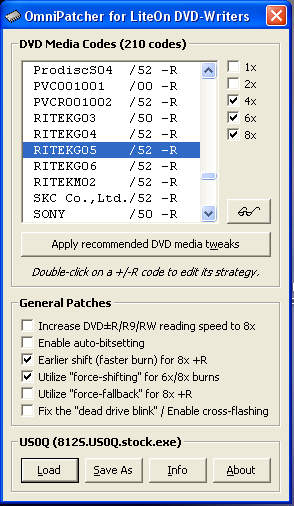

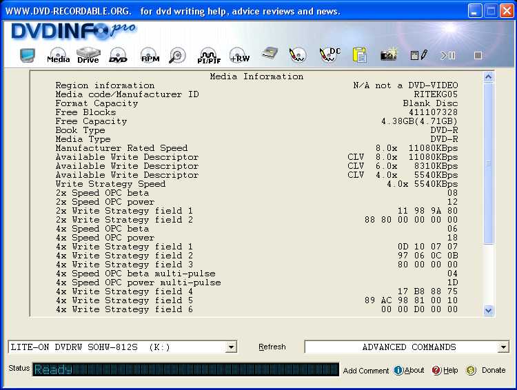

    Are you familiar with dvdrw_omnipatcher ?
    It has a feature that makes your drive shift into a faster speed at the start of a burn....
    Earlier shift (faster burn) for 8x +R
    (only for 811S, 851S, and 8x2S) This was one of the two components that made up what used to be called a "burn-adjusted" firmware. This patch will cause your drive to shift into higher speeds earlier and more aggressively, thus speeding up the burn. On some burners, this aggressive shifting may result in lower-quality burns, which is why it is highly recommended that you experiment with it and see if it works well for your particular drive. If it doesn't, then don't use it. If you select this, then you should also select the "force-shifting" patch
    Although it say's for +R i may try it......
    Write strategies
    Each media code in the firmware has a "write strategy" assigned to it that will tell the burner how a piece of media should be burned. These write strategies are very closely tied to the burn quality of the media that you feed the drive. In many cases, the write strategy already in place for a particular media code is the best one to use. Using a write strategy that is very badly suited for a media type will most likely result in a bad burn and might potentially have negative effects on the laser of your drive, so going around switching write strategies at random is usually not a good idea, especially if the one specially designed for that media type already works well. However, there are some cases (especially when overspeeding) where using the write strategy for another media type will help improve burn quality. For example, overspeeding a PRODISCR02 to 8x using the PRODISCR02 code will most likely result in a coaster once the disc hits the 6x and 8x regions of the burn. However, if a PRODISCR03 strategy is used, the disc will burn much better when oversped to 8x.
    Recommended write strategy replacements
    These write strategy replacements, which can be applied by clicking the button labeled Apply recommended DVD media tweaks will apply write strategy replacements that are known to work well. As the name suggests, doing this is usually a good idea. The media codes affected will have a '!' next to them in the media code list.
    Manual write strategy replacements
    Double-clicking on a +R or -R media code (not RW!) should bring up a list of available write strategies that you can use for this media code. The write strategy currently in use will be highlighted. In the main window, any media code that is using a write strategy other than its own will be marked with a '!'.
    I may have to play with this a little seeing as i'm waiting for my NEC 8)

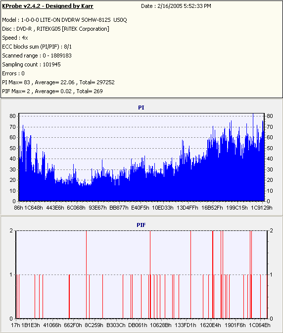

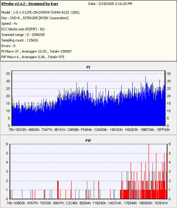

    Okay,
    what do you make of this ??
  11. I make it GOOD! :P Great PIF numbers. Did you change the firmware, or burn speed, or was it just another disc with same setup or ?

    i used the Omni Patcher to change my firmware
    I chose the RITEKG05 and clicked apply recommended media tweaks,
    checked the 2 options as seen and made a new firmware, applied, restarted and this is the burn i got
    you can see what the applied changes do from my earlier post, don't know if it made a diff.as it says for "+" but i'm gonna try another one right now to see..... damn freaked me out when i saw that scan done!!!
    Major Change!!!!!!!!!!!
    And i've always used the latest firmware, i just used this to enable auto bit setting. until now....
    Oh Yeah, still burned at 8X

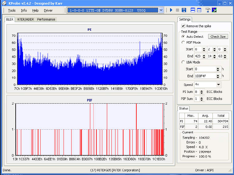

    Okay, here is the next one burned at 8X after the tweaks were applied with omni patcher!!!!
    Not as low as the fuji TY's but it's a hell of alot better than 600-700!!!!!!
  16. Dahyum :P
    It looks like that is what is creating good burns, forcing it to not use the 4x write strategy as I suggested. Nice, the PI is only average, but the PIF is very good, and that's the main thing. It looks a hell of a lot better, I'm glad you found something that works.

    Okay, i just ran a scan on the Ritek, it's weird because the scans that i was getting all of a sudden of the riteks were going to shit near the end of the disc, the opposite of the first ones ??
    Now here is a scan of my first burn at 8X on the NEC ND-3520A
    i'm gonna try a 6X burn next.....
    (when my scans were starting to get worse on the liteon i lowered the speed to 6X and they got better when they were better at a 8X previously ??)

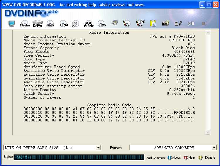

    Look at the diff. in these PRODISC R03 hub printables!!!!!
    https://www.videohelp.com/forum/viewtopic.php?p=1229399#1229399
