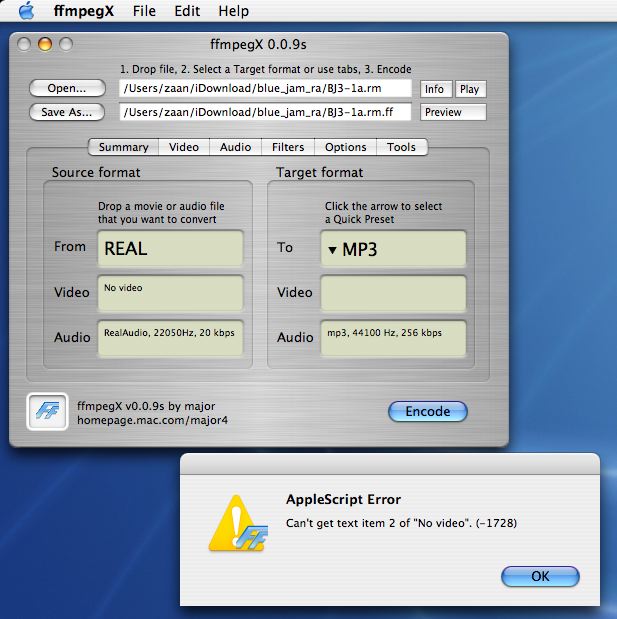

When I try to encode a .rm (realmedia without video in this case) to an mp3 file, I get an error, that is plain gobbledygook to me (see attached jpg for a screenshot of the dialog). What is the cause of this? Am I doing something wrong?
PS: This is using the latest version of ffmpegX and the 'stable' version of reallib as linked to on ffmpegX's homepage (the one that is downloaded from sourceforge).
Also, I just chose the "audio file to mp3" preset option on the right hand side of the pane in the picture. I did tweak the audio options in the audio tab, but I didn't chose anything that is not visible here (I just lowered the frequency and upped the bitrate). I also get the error when I chose "movie audio to mp3".
