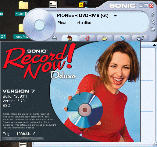

    i've got recordnow max 7 business edition.. i'm not sure if its 7.2 though. here's a screencap of the info screen.
    Usually, if RecordNow is compatible with DL, then it will say DVDRW9 for DL drives. If your Pioneer is DL then probably your version of RecordNow is not compatible, because it just says DVDRW instead of DVDRW9. That's how it was with me and version 7.0. But after I upgraded to 7.2 everything became normal. Here's my screenshot (I wiped out the serial number though):
    P.S.: Yes, re-authoring in DVD Maestro and then using PgcEdit and burning in RN 7.2 is the best way to go with your material.
