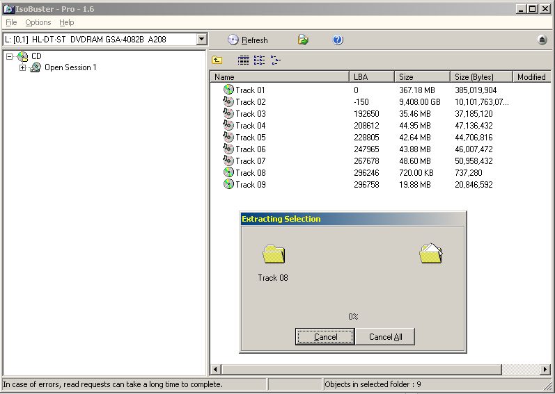

Ive tried always trusty ISOBuster, and voila - there is track09
But the problem is ISOBuster can't extract content of this track(session). It always stuck at 0% (I just forced-close it after 6 hrs).
So what are my other options/ways to get content of this track on my hdd?

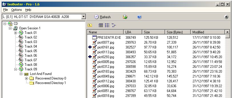

now my lg dvd-writer is able to see content of this disc (with Nero5 see up to track8, ISObuster 1.6 can see all 9 tracks), but i can't extract the last track/session 09
here is the isobuster's screenshot:
