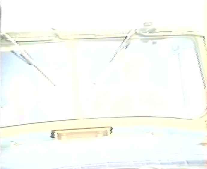

After burning dozens of dvds from VHS home recordings, I started to notice over exposed scenes especially in snowy
background or scenes with camera facing the sunlight.
When i playback my VHS on my VCR everything is fine. I think it is happening during the capture.
I use Scenylizer, PinnacleDV500, S-Video or Composite.
Please check the attached image. It is supposed to be normal where you can see the faces of the people in the car. But as you can see it is too bright (over exposed).
Please advice.

whoa - even i can not fix that
8 bits (256 levels) is a tight "window" for capture. You need to "ride the gain" for white levels scene by scene during capture to handle the wider range of black to white than 256 levels can deliver. When the gain is too hot, you get clipping, loss of gray scale in sum a washed out image.

Looks like MV to me. This is what all my caps look like without the SIMA SCC in the signal path.

Video level needs to come down. You need a Color Corrector like Elite BVP 4 or Signalone, a professional corrector.
Key issue to understand is that levels need to be correctly set before capture for 8 bit systems. There is not enough dynamic range to correct seriously hot or low white levels. The image shown above cannot be fixed with a digital filter. The data is not there.Originally Posted by Marvingj
It needs to be recaptured with the correct setting for white level. -
If you cannot recapture but need a quick fix, then used a professional color corrector. It can help, but won't do miracles.
i do color correction commercially -- believe me .. that image above is not correctable in post

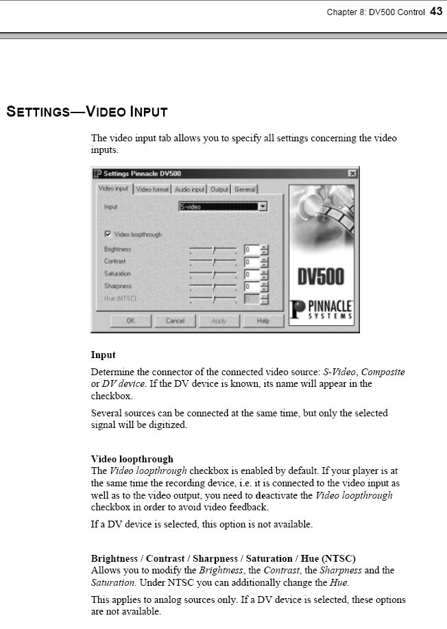

The Pinnacle DV500 should have white level (also saturation hue etc.) settings for the analog inputs in the capture menus. If your Premiere is recent you have the waveform monitor, get the whites under 100IRE. If its an older Premiere, you may want to do some trial and error caps until you find the right white level.Originally Posted by amira
Added: Here are the controls for the DV500

Those controls only operate while capturing video. Since the DV500 has no waveform monitor, you need to repeat capture in a trial and error fashion until you find settings you like.Originally Posted by amira

The DV500 is a capture card and the capture input setting menu is posted above. Unless you are prepared to spend >$200 you won't do any better. That was a $1000 card when new.
Experiment with "Brightness" and "Contrast" until you get an acceptable picture. You will capture, evaluate, adjust and repeat until you get it right. Then adjust saturation for color level.
If you do buy somthing new, it needs adjustable input levels like the DV500.

Now, amira said the video can be viewed OK from the VCR. He also implied that the picture above was the result after capture. If this is true, the problem was capture levels. If the picture looked OK after capture and then washed out during MPeg encoding, then the problem is the encoder.
From my experience, looking at amira's picture, I concluded that the video was not captured with proper black and white levels. If we could see the "before" image, we could see if this is due to no black reference in the picture or squashed whites due to camera exposure.
