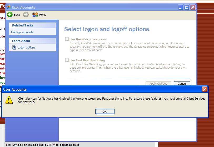

anyways when i go to the users panel it gives me this error
And i cant seem to find where to uninstall that?

Ok, i got it i uninstalled netware thing in control panel/network connections and everything worked! Thanks ffor the help!
