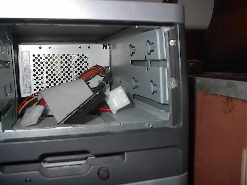

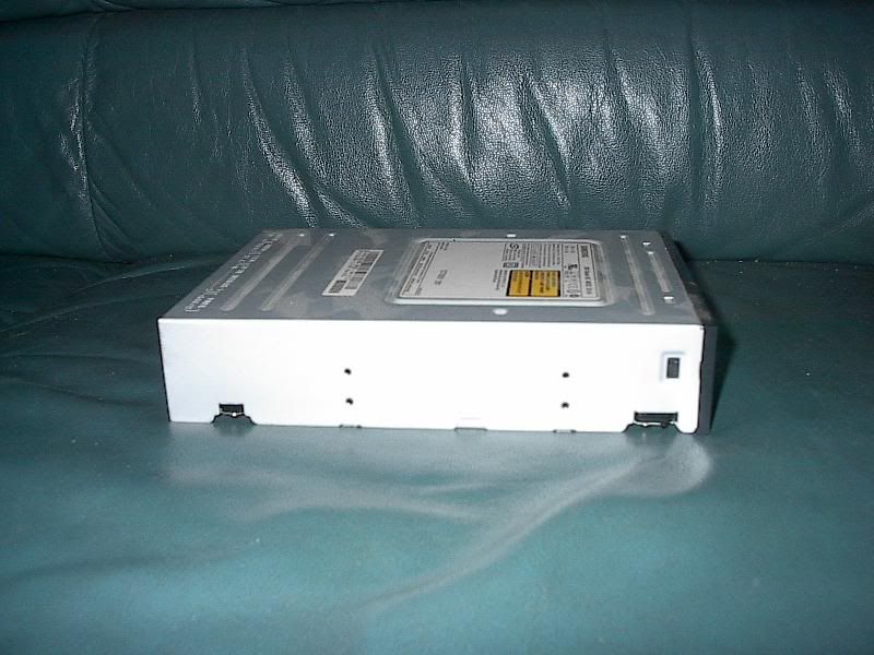

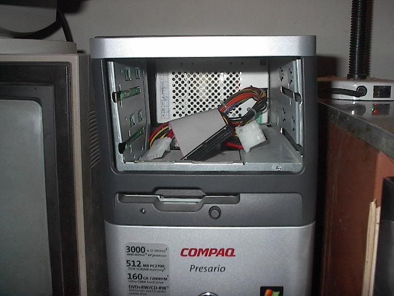

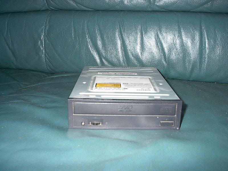

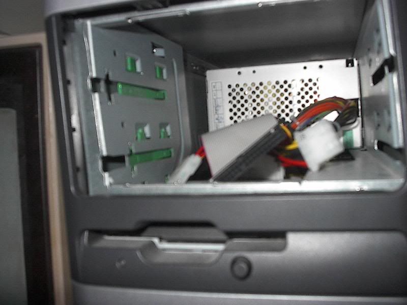

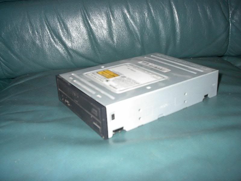

  8. i got the PC to work thanks for all the help guys, but i have one more question and its about installing drives. my friend gave me this PC and when he gave it to me he took out the drives and i wont to put drives into it. are all the drives install the same, meaning can i use my dells rails to install in my compaq? he did not give me any rails to install drives.
    here are some pitures of the drive spot on the PC and the drive i want to put in. am i missing anything? i dont see any place to put the drive. if i take the drive out of my dell will i be able to use the rails of the dell?
  9. You should have some coloured rails that screw on to the sides of the drives (with fine-thread screws), then they slot in. You could try looking inside the case, on the bottom. Manufacturers often put plenty of spare rails/clips there!
    Make sure your drives are set to Master and Slave - a DVD-ROM should be Slave to a writer (either DVD or CD) which should be set to Master. You do this with the jumpers on the back.
    Hope this helps,
    Cobra
  10. If you look inside the case (take the sides off), you will see screw holes where the drive will go, matching up with the screw holes in the drive.
    Just slide it in, and screw in place (your pictures are excellent, and show the holes even)
    Make sure you use the right size screws though, too long and you could damage the drive.
    Cheers, Jim
    My DVDLab Guides
  11. hhhmm Compaq, looks like the one in the Futureshop flyer this week, it's 2 months old take it back don't tell them you kicked it over just say it stopped working.
  12. sorry when you said it was 2 months old I thought you ment you bought it from a store, I just red more sorry.

  14. The last Presario I worked on, looks identical to that, has screw holes...(shrug).

  17. Originally Posted by reboot

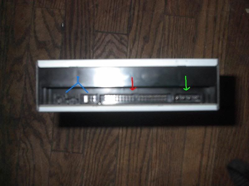

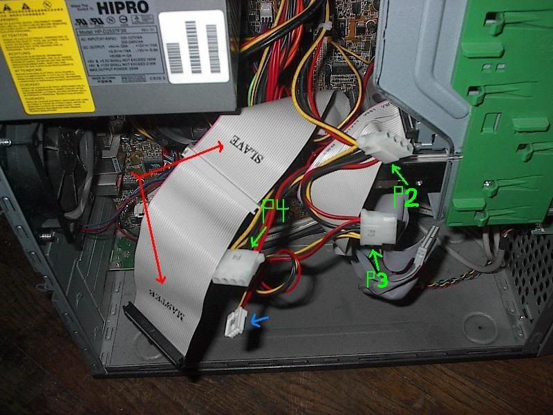

    ok i see it when i opened up the PC, i saw that theres 3 wires that are labeled P2 P3 P4 (witch u will see in the pic) witch wire do i put in the master and witch one do i put in the slave. the (blue arrow)wire does not fix in any of the slots in the back of the drive. were does the (blue arrow) wire go (it saids P8 on it)
    (heres the drives back) i did not see any wires that fits in the section were the blue arrow is. i took a stab at it and the drive would read cdr's but not dvd-rw. im not shore if dvd rom drives can read dvd-rw, or i just hooked up the drive wrong. can some help me out with hooking my drives up?

    i'll take a stab at it and say put the master in the drive with the jumper marked master and the plug on the same cable in the drive with the jumper marked slave ...
    the blue arrow thing is for a floppy ..
  19. P2, P3, P4 are interchangeable. Plug em in wherever you need to. One for hard drive, one for CD, and one for whatever other drive you're going to install.
    Master (light grey cable) looks like it goes to the CD-ROM. Slave goes nowhere.
    The other large (dark grey) cable goes to your hard drive, with the END of the cable, not the middle connector (should also be marked master).
    The little molex plug (blue arrow) is for your floppy drive. If there's one there already, leave it.
    Cheers, Jim
    My DVDLab Guides
  20. Originally Posted by reboot
    so the 2 blue arrows in the drive pic theres no wires for theses slots? because when i install my dvd burner into my dell PC there was a wire for that slot, or is that because it a dell?

    in your second pic -- the one out of focus , the blue thing is pointing to two things . the one on the right is the jumpers - leave alone
    the one on the left is for digital audio and the other end would go to the mother board or a sound card (if there is one - prob. not)

    And, too, the pics show what sure as hell looks like a 40 wire ribbon cable, small slow drive. Should be changed.
    No, the master always goes on the end of the cable. Single drive, mebbe the center connector will work, but end is normal for master.
    In Cable Select system, automatically the end is the Master.
